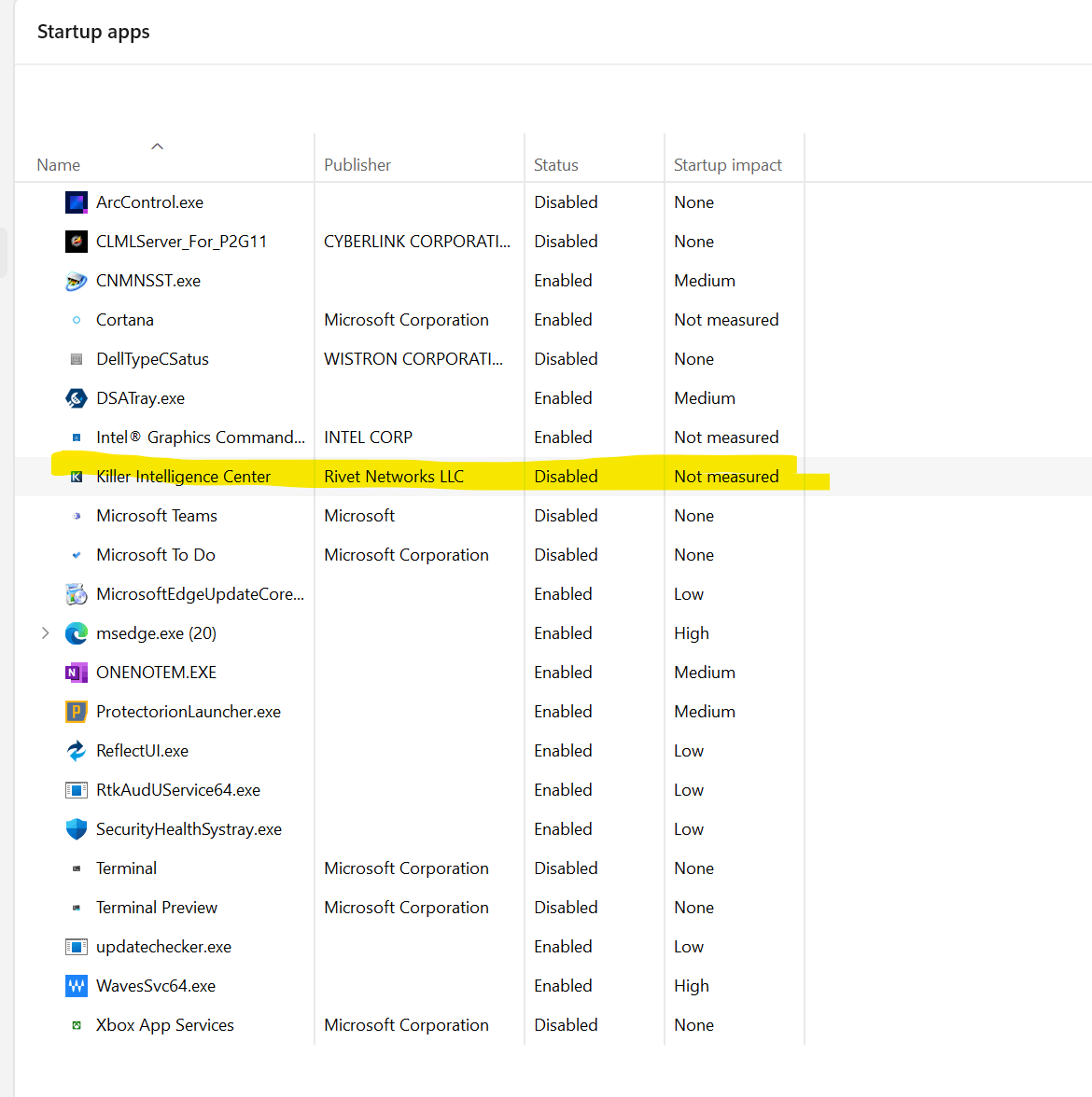

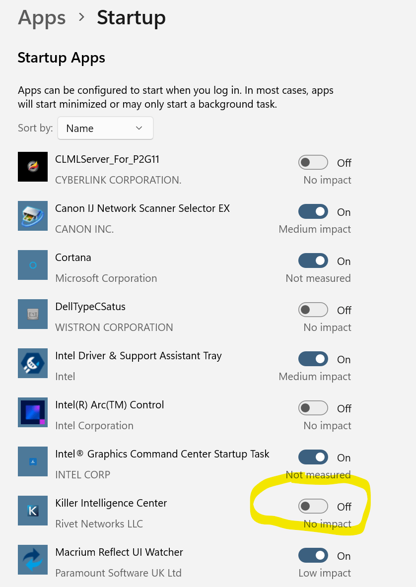

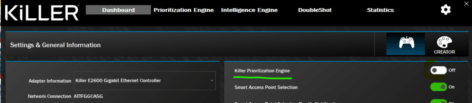

    You should file feedback to Intel since they now own Rivet Network. The Killer performance suite that gets downloaded is no longer compatible with the old Ethernet E2400 adapter it is meant for the Wi-Fi AX1650 and the newer Ethernet E2600.
    When you have the older Ethernet E2400 it ends up adding this bug for the upload speed.
    To avoid the problem with the E2400 Ethernet, I had to take the 3 actions below.
    1. I turned off Killer Prioritization Engine
    2. I prevent the Killer performance suite from starting by turning it off in the Apps > Startup
    3. I disable the Killer Network Service
    Clearly this is not necessary if you use Wi-Fi instead of the E2400 Ethernet.
    1)
    2)
    3)

    Perfeito, foi o que solucionou no meu.
    Você precisa abri o programa Killer Intelligence Center, via clicar na aba Prioritization Engine - Mais embaixo vai clicar na seta para a direita, onde tem Configurações atuais de largura AutoBanda - e por ultimo desabilitar o Killer Prioritization Engine.
