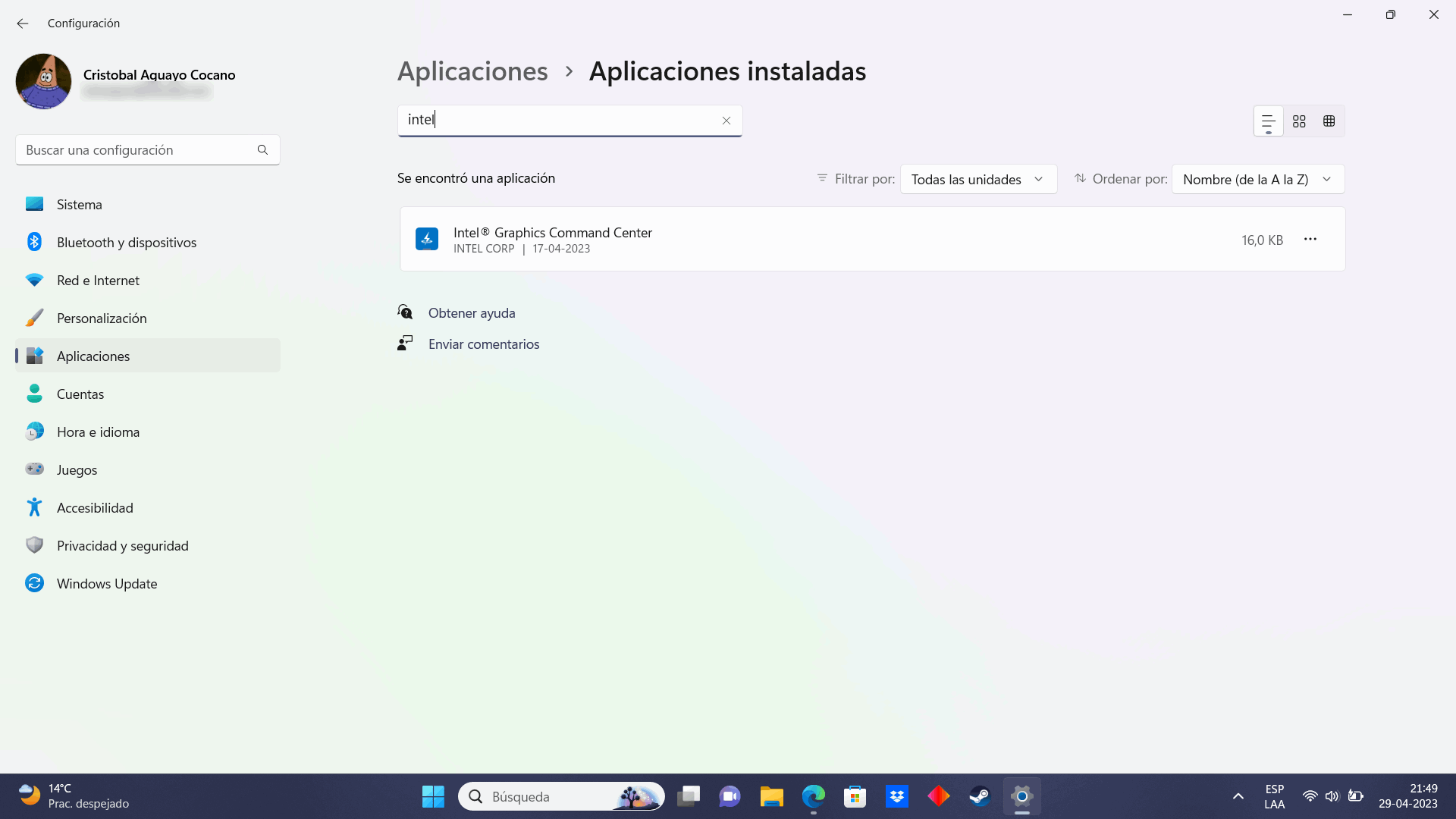

    i tried to find the intel extreme tuning utility, but nothing

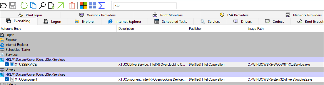

    See if any of these instructions work to uninstall the XTU:
    https://www.intel.com/content/www/us/en/support/articles/000032459/processors/processor-utilities-and-programs.html
    Remove these entries related to the XTU:
    Run Autoruns as administrator
    In the Quick Filter box enter: xtu
    Right click on each of the entries found and delete

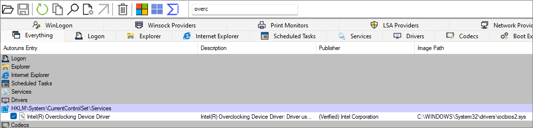

    In the Quick Filter box enter: overc
    Delete that entry
