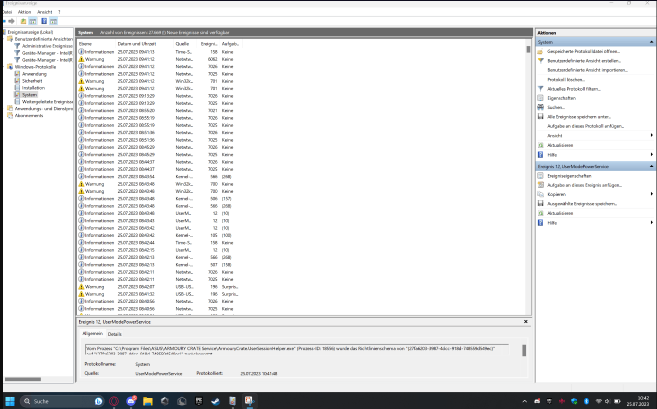

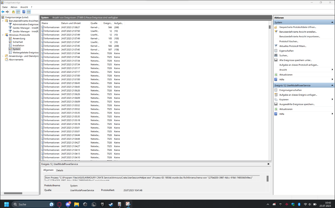

hey yall
i got an issue with my new rog flow z13
so basically win32k usb-usbhub3 and netwtw12 spam event viewer
i tried reinstalling and updating the network driver
here are the screenshots and the event viewer log
also i had the same on my surface so i think that intel just has trash drivers
the surface also had the same wifi card https://www.mediafire.com/file/xlxnze5rwnyywfs/events_%25281%2529.evtx/file

  3. DaveM121 932.6K Reputation points Independent Advisor
    2023-07-25T09:40:59+00:00
    Because that is listed in the event viewer and is a major cause of issues, it is best to re-install it.
    2023-07-25T09:35:26+00:00
    why uninstall armoury?
  5. DaveM121 932.6K Reputation points Independent Advisor
    2023-07-25T09:21:40+00:00
    Hi xd nqrwayy 9000,
    I am Dave, I will help you with this.
    Completely uninstall Armory Crate.
    Then go too the support page for your PC or motherboard on the manufacturers website, form there, download and re-install the Intel WiFi card drivers they provide, then re-install Armory Crate
