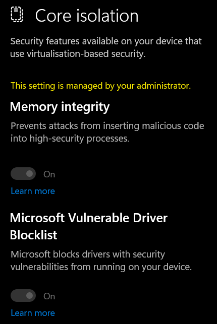

    FYI the first command gave me an error, but I did not need it anyway because I already had the Microsoft Virtualization feature enabled. (I already had core isolation active earlier and then I disabled it to install Huawei HiSuite to backup my Huawei phone and its drivers are not compatible with core isolation, but after I finished and tried to reenable core isolation it wouldn't no matter how hard I tried to remove all Huawei incompatible drivers)
    I must inform you though that after applying this method, I am unable to disable the core isolation directly from the settings, it says now that this setting is managed by the administrator (I am the administrator though)
