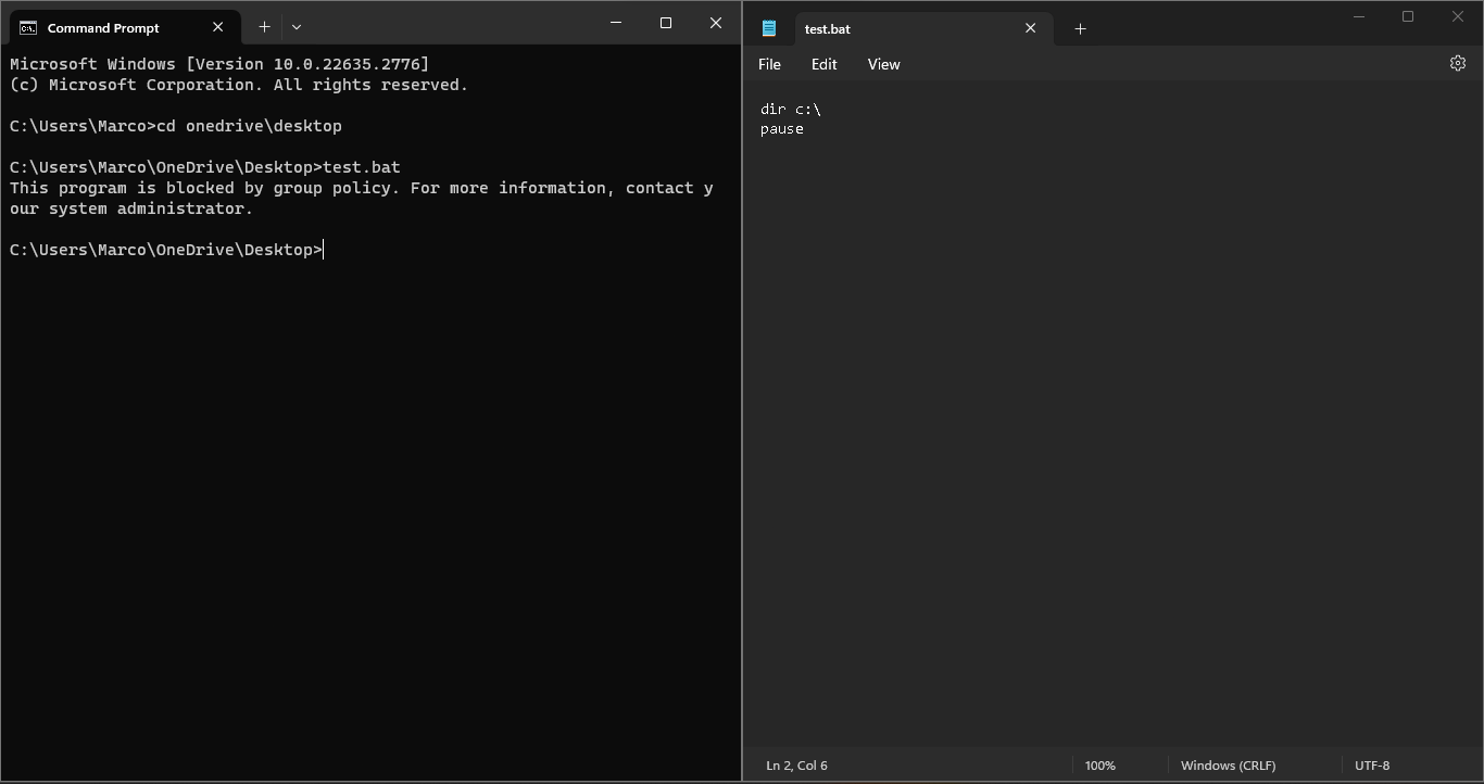

    Update to post above i can run a simple batch file as see in the SS below.
    As you can see from the 1st screenshot, the simple batch file did not run. So, the problem is for all batch files; there is nothing specific to activate.bat.
    Will prepare a fixlist to reset the GPO.

  3. Ramesh 181.6K Reputation points Volunteer Moderator
    2023-12-03T13:25:45+00:00
    1. Run the fixlist as follows:
    • Download FixList.txt
    • Save Fixlist.txt in the same folder where EnglishFRST64.exe is.
    • Close all program windows.
    • Launch the Farbar Scanner tool and click "Fix".
    • Upload the output log file (FixLog.txt) to your OneDrive.
    1. Please try renaming test.bat to test.cmd and running it.
