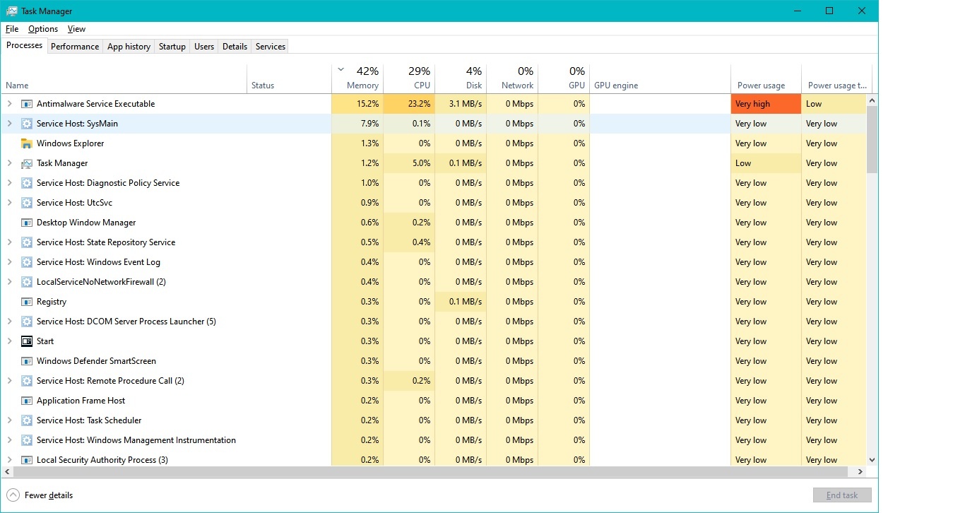

Win10 64. Defrag runs constantly, grinding away at my hard drives for no reason. The both drives are 0% fragmented, except for system reserved files which are 40% fragmented and defrag will not touch them. The Defrag is OFF, how do I stop the system running defrag every time the PC is idle for more than 60 seconds?? How do I defrage the system files which need defragging?

    Thanks. as the computer is bogging down anytime a process is performing disk read/write I'd be checking the hard drive. See if your drive manufacturer has a diagnostic tool.
    Follow with, from an admin Command Prompt chkdsk C: /f /r
    Let it run the check at the next boot.

    Yesterday it started getting worse. I ran a full scan, no bugs, but the antimalware service executable in task manager just kept running, so I rebooted it and a few minutes after I restarted it, it started to 'misfire', HD stop-starting. Stripped the PC, blew it out with an air line, and now it is behaving itself.......
    I will give it a few days to see if it comes back, if it doesn't, I guess it was dust bunnies in the PSU, boards, wiring etc.
