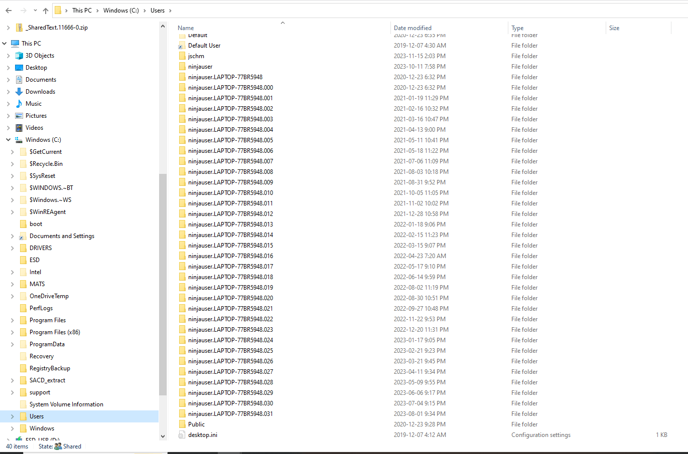

There are a lot of unwanted/invalid profiles. Download and run del_unwanted_profiles.reg. Click Yes to confirm.
(As you've already backed up the key to "Profilebad.hive", go ahead and run the above registry fix without any hesitation.)
Re-run the Windows setup now.
