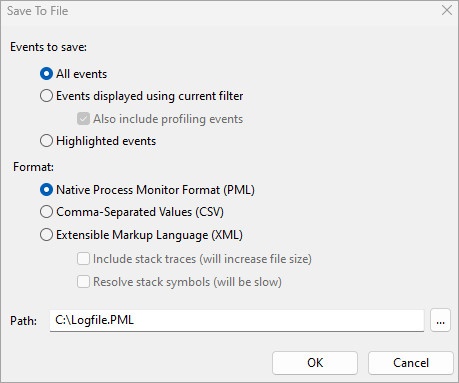

  4. _AW_ 69,496 Reputation points Volunteer Moderator
    2024-02-13T13:35:00+00:00
    We probably need to get a Process Monitor capture to see what is happening.
    https://learn.microsoft.com/en-us/sysinternals/downloads/procmon
    Right click Procmon64.exe and run as administrator. The capture button is third from the left.
    • Start capturing, reproduce the problem. Stop capturing.
    • Press Ctrl + S, select All events under Events to save > save the log
    • Zip the log and share on your OneDrive or similar
    Share OneDrive files and folders - Microsoft Support
