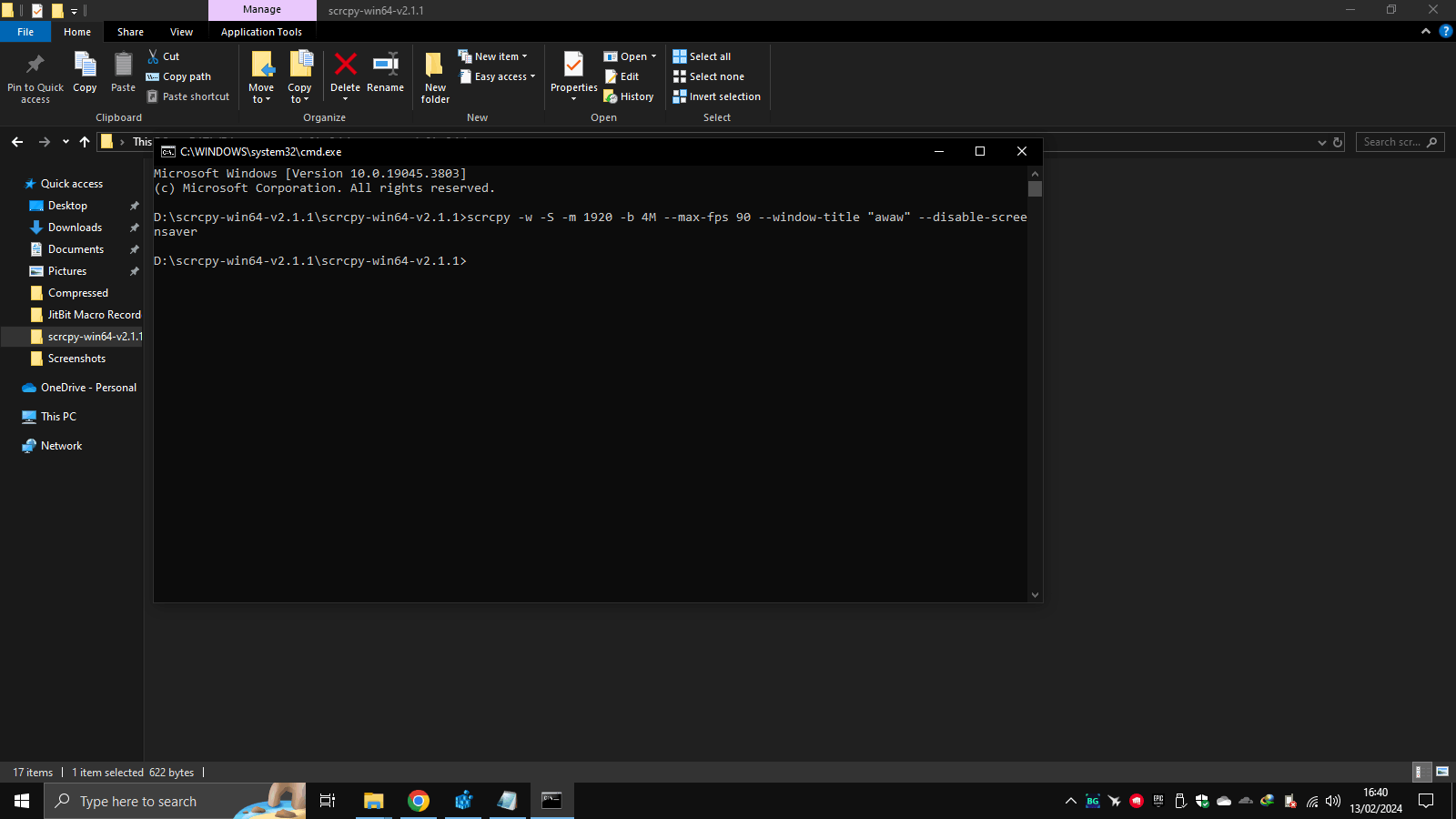

so i just running .exe regedit from this website https://www.tenforums.com/tutorials/8703-restore-default-file-type-associations-windows-10-a.html the file format is exe.reg ,after running this , ican't run scrcpy (android screen to windows) please help

    what does it do '-' ? my problem fixed sir i can run scrcpy now because your answer before, do you talking about the cmd in the picture is malware ? those cmd mean success run scrcpy
