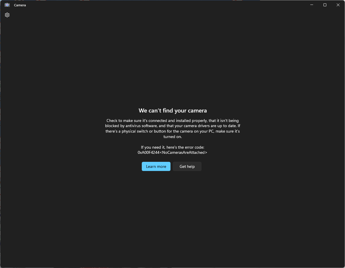

How do I resolve this camera issue? Camera app shows error "0xA00F4244 NoCamerasAreAttached"
