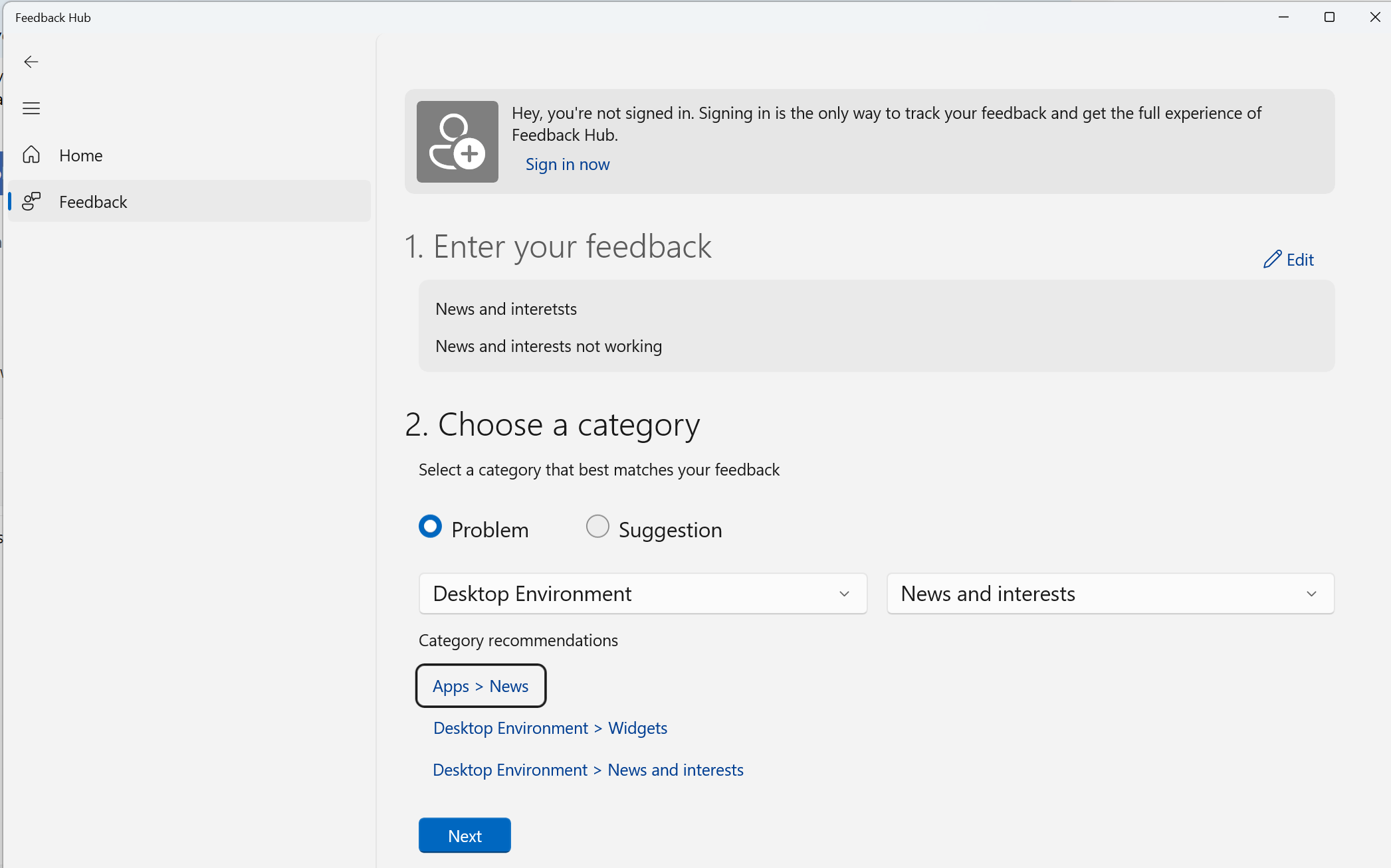

    Can you submit a feedback using Feedback APP? Select News and Interests, Select Desktop Environment - News and Interests in the category. Please try to record the problem using the record button in the feedback hub. News and interest team may be able to diagnose this issue and return with suggestion.
