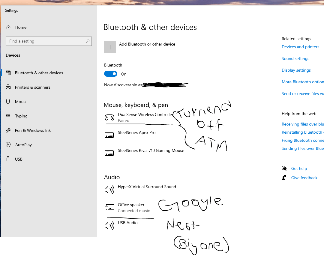

    Nothing connected by whire or usb.
    I have the wifi antenna from the motherboard,
    and the google speaker(google nest charchole) i have is connected by bluethooth, it connect automaticly on boot up.
    The ps5 controller i use also is connected by bluethooth, but its turned off atm
    2024-06-26T18:28:27+00:00
    Most likely it is the drivers for the PS5 controller that driver refers to, I do not see any other device it could be.
