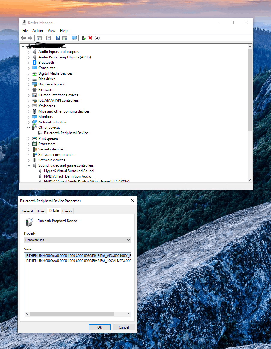

    Do you have any external Bluetooth devices connected to your PC?
    2024-06-26T17:52:09+00:00
    I downloaded them from armour crate and it worked, they are gone :)
    Thank you
    now its this one:
    Bluetooth Peripheral Device
    : BTHENUM{0000fea0-0000-1000-8000-00805f9b34fb}_VID&0001000f_PID&1200
    I have the laster bluethooth driver installed from asus suport page (y)
