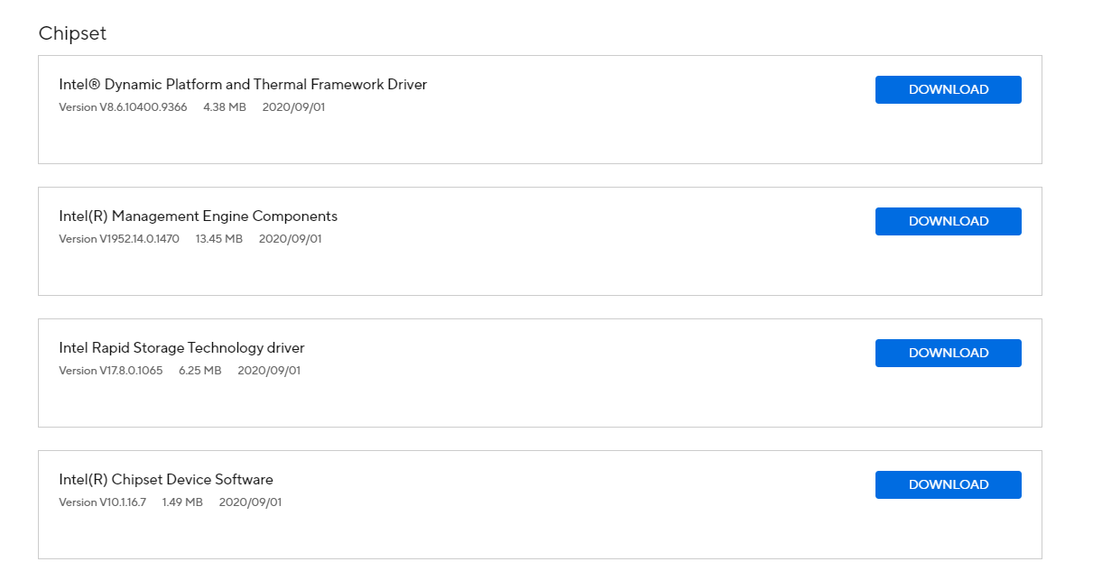

    When you say "latest drivers" are you talking about the previous drivers you mentions specifically?
    From your previous message:
    Edit: when you mean by download latest drivers are you talking about these? or specific ones from the websites, if so you could provide the download link?
    Edit 2: I went ahead and installed of them and I just created a restore point "B4 Drivers." Ill get back to you about the performance. I also got this pop up and just said yes.

  3. David-M 126.5K Reputation points Independent Advisor
    2024-06-07T12:44:37+00:00
    Sorry for the delay in reply. I didn't receive notification of your reply.
    These are the drivers I suggested installing. Just look at the release date. Install only the latest versions.
    I suggest installing the latest drivers from the other categories.
    (Networking, Audio, Graphics, Pointing Device, and Bluetooth.)
    For now, don't install anything suggested under the category "Utilities".
