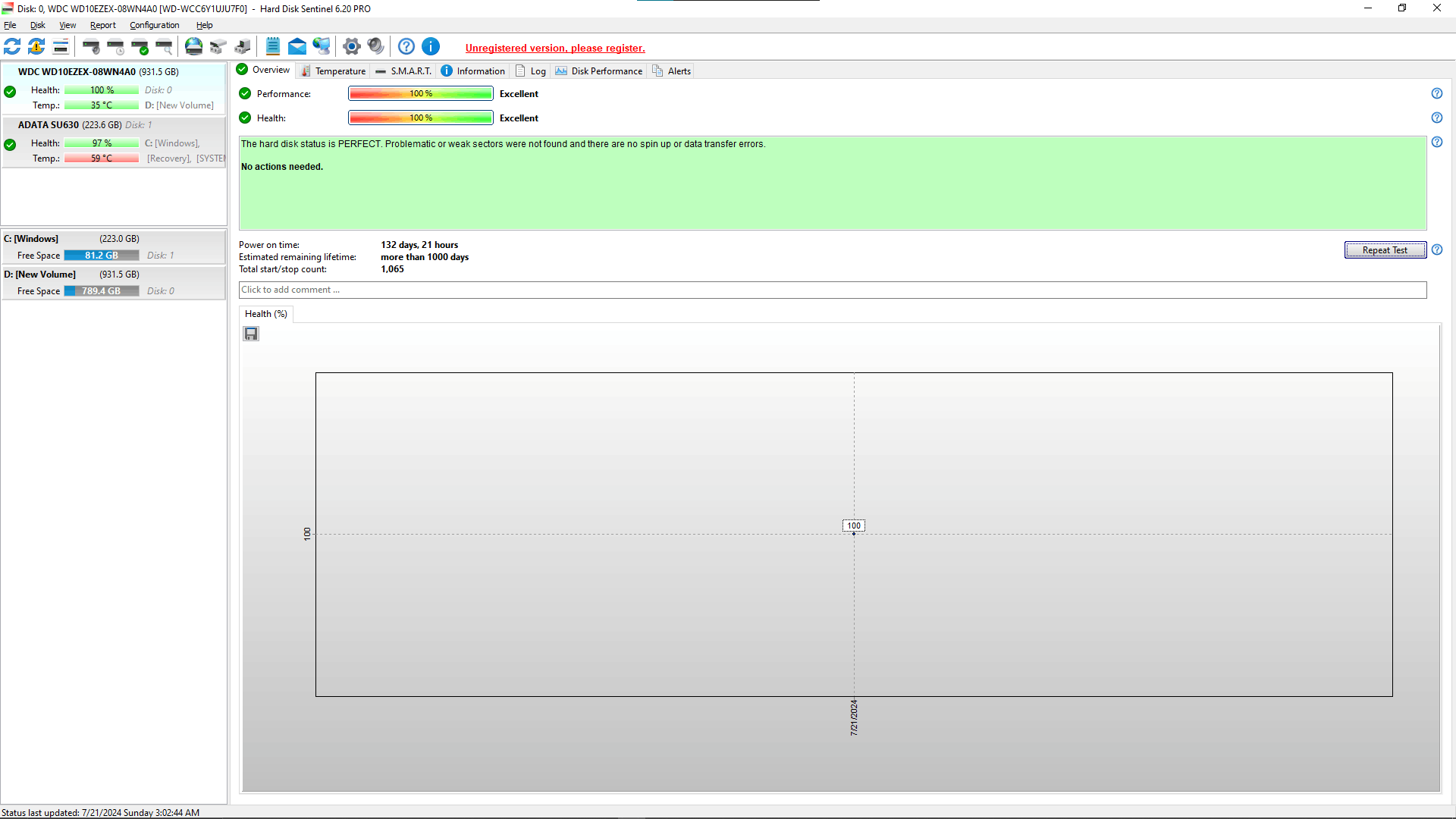

    2024-07-21T09:04:42+00:00
    STEP 5 A) Overview-- D: Drive
