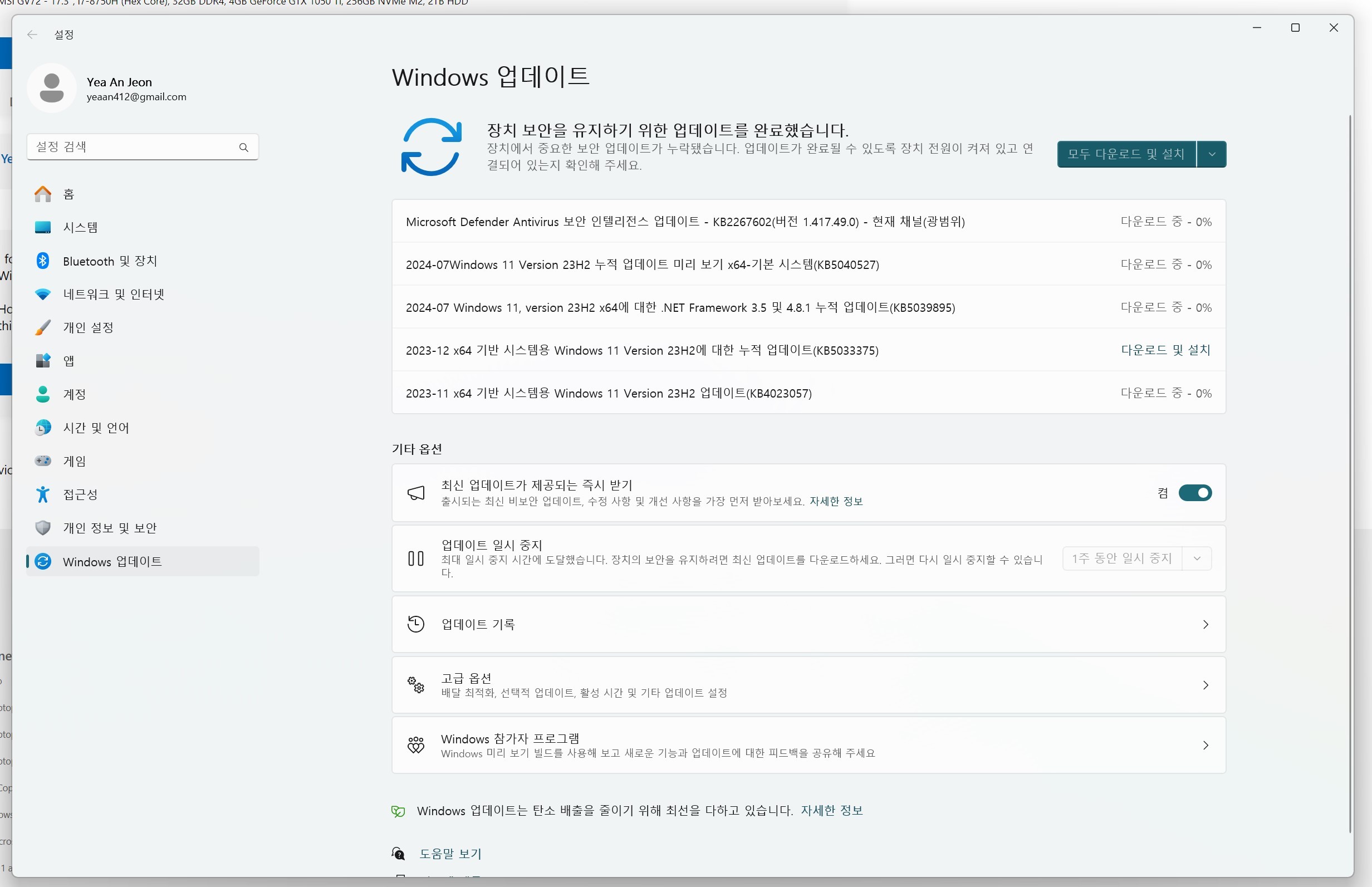

    Did you donwload the ISO with that tool, and then double click the ISO and run Setup.exe on the ISO from inside File Explorer to perform the in-place repair?
    2024-08-10T10:04:44+00:00
    I forgot to do that part, sorry! I just finished all the updates, and I’m happy to report that my computer seems to be back to normal. The Windows Update doesn’t show any errors, and all the icons on the Start screen are displaying correctly. Thank you!
    However, it says that an important security update is missing on the device, and I’m trying to install it, but it’s stuck at 0% with no progress. Could this update normally take a very long time?
    2024-08-10T10:05:58+00:00
    What is the KB number of that security update?
