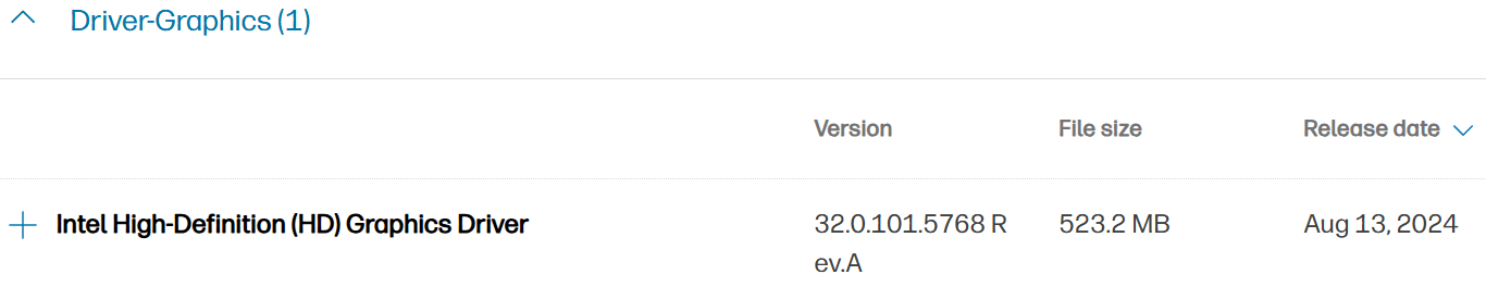

    Yes but this driver should come normaly from HP and HP Spupport Assitance is still showing that driver is up to date.
    To use graphic driver not tested from the producer in this case HP can cause maybe other issues, what do you think?
    Did you have also this graphic driver before downloading 101.6458_101.6257 ?

    I have already tried the non HP drivers, they install firm but don't do anything to resolve the issue
