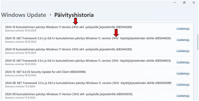

    My Lenovo's (Ideapad 310-15IKB) new Windows 11 version (24H2) got 2 more updates right away after installation --> Windows Update (SCREENSHOT).
    I then tested a lot of functions and applications for a few hours (e.g. Microsoft 365 Office (paid), F-Secure Antivirus (paid), New Outlook, Firefox, Edge, Chrome, Lenovo apps, etc.)
    **Everything worked fast and stable = normally!**👍
