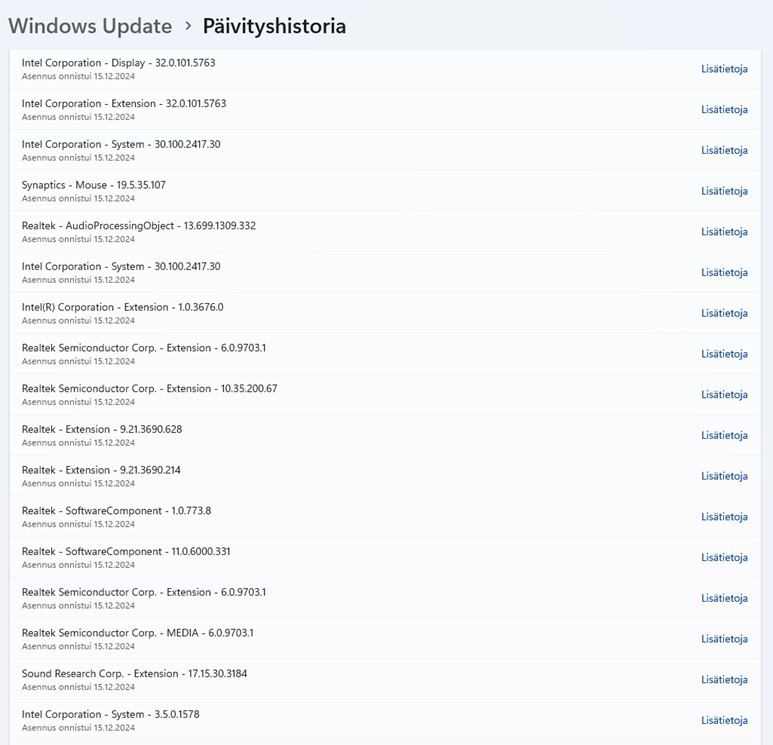

    After I successfully👍👍updated my computer to version 24H2 using Windows 11 Installation Assistant on Dec 15 --> 2 quality updates and 17 driver updates (quite a lot)😮🤔came next to Windows Update (SCREENSHOT).
    SUMMARY: The installation was easy from start to finish. I am completely satisfied with the well-functioning 24H2 version.
    **I can recommend this installation method to everyone - to be performed as an alternative - if necessary.**🤔😁
