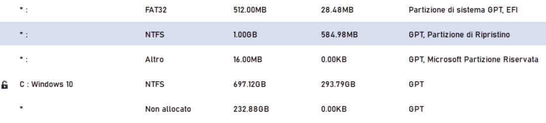

    From your first image, I see:
    where the highlighted row seems to confirm that you have sufficient space for the update to run.
    The image also shows 232 (!) Gigabytes of unallocated disk-space following the "C:" partition.
    Do you have a planned usage for that space, or do you want to use Disk Management to "extend" the "C:" partition?
