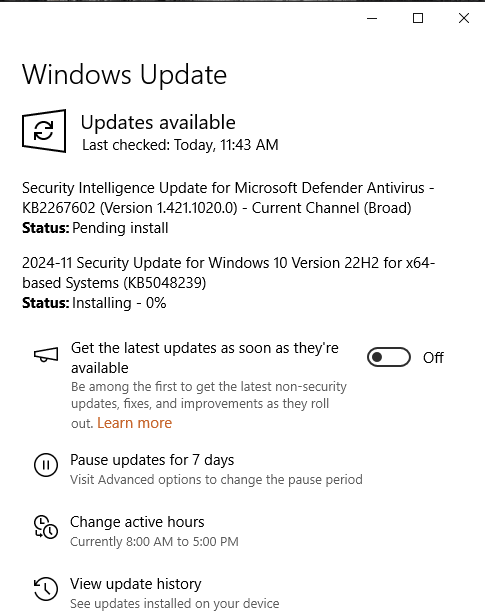

I have exactly the same problem as this (reported earlier this year), but with the new KB5048239 update. I get the 0x80070643 error when it tries to install. Retried several times, but same issue. I'm pretty sure this is the same problem that I had back in January, too. All security updates have worked fine since then, till now. At that time I was told that this was a general problem with the update and a fix was being made by Microsoft. I did wait and eventually that previous update went away. Now here we are again...
The 2024-01 Security Update for Windows 10 Version 22H2 for x64-based Systems (KB5034441) will not install on my Windows 10 laptop computer.
I get the following message There were some problems installing updates, but we'll try again later. If you keep seeing this and want to search the web or contact support for information, this may help: (0x80070643) Retry
When I click on Retry it says its Installing-0% for a few minutes then Installed-100% and then I get Download Error (0x80070643) There were some problems installing updates, but we'll try again later. If you keep seeing this and want to search the web or contact support for information, this may help: (0x80070643) Retry
Windows Update Troubleshooter could not fix this problem.
I'm not sure what to do, please help.
Thank you

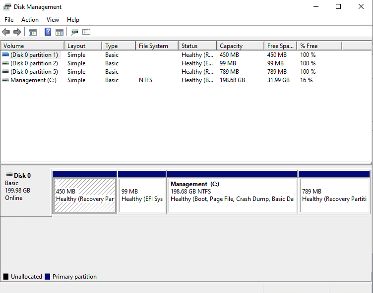

    It is curious that the size of the current disk-drive is 200 GB.
    This implies that the disk-drive is very old, because "new" disk-drives usually are sized as 120 or 128 or 240 or 256 or 500 or 512 or 1024 GB. Old disk-drives "spin", causing "rotational delay" each time there is read/write access. Also, old disk-drives transfer data at either "SATA" (1.5 Gbps) or "SATA2" (3 Gbps) or "SATA3" (6 Gbps) speeds. New disk-drives transfer at "SATA3" speed, if the motherboard supports it, or at "SATA2" speed. New disk-drives have ZERO "rotational delay", making them much faster.
    The posted image points to "partition5" as the WinRE partition -- not to "partition1". So, I suspect that if you attempt a "recovery", then "partition1" will NOT be used. One way to confirm this is:

    > On this end this is a W10 Hyper-V guest.
    Do you have a Windows 11 "host", with Hyper-V having a Windows 10 "guest" operating system?
    > I also have two recovery partitions one is 450mb and the other is 789mb which is the active one and is at the end of the disk after my C:
    The early releases (in 2015) located the "Recovery" partition at the start of the disk-drive. That explains the 450 MB partition.
    When I use the "reagentc /info" command, I see:
    **Recovery Environment:**
    *\?\GLOBALROOT\device\harddisk0\partition2\Recovery*
    Harddisk "zero" is my computer's first disk-drive,
    while "partition2" is the 3rd partition on my disk-drive.
    Do you see "partition1" in the output on your computer, or "partition5 ? If the former, then that partition is too small for the update to be applied. If the latter, then the 789 MB might be too small.
    Do not believe that "0% used" tag for your "partition 5".
    Unfortunately, the "hidden" files/folders are not counted, when giving that "0%" result. Sigh.
    You must have installed Windows 11 a LONG time ago, to have that partition at the start of your disk-drive.
    There do exist free utilities that will "shrink" your "C:" partition by some amount, e.g., 1000 MB, and then to "expand" your 5th partition by that amount, namely 1000 MB plus the 790 MB.
    Then, retry the Microsoft update.
