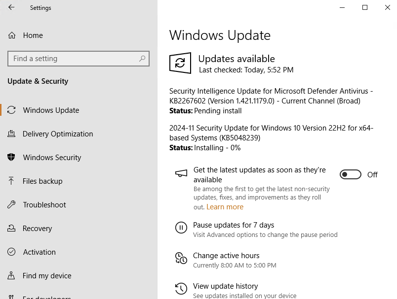

    2025-01-04T07:26:05+00:00
    the guest, update runs and then after some period of time closes itself. .... neither of these install
    The first update is to the Windows Defender anti-virus software.
    If Windows Update is running correctly, the failure of the other update to install should NOT cause the update to Defender to fail.
    Can you double-click the green-coloured "shield" icon for Defender (in the System Tray at the bottom of the screen) and manually force it to try to update. Is this successful?
    Then, go back to Windows Update, and click on "Update History", to see the newest date on which KB2267602 was successfully installed, and the list of dates on which it was installed.
    Then, do a "check for updates", to see if ONE (or TWO) updates are offered.
    This might be corruption within the Windows Update app.
    There is a Microsoft "troubleshooter" for issues with Windows Update. Run it, and see if it makes any changes.

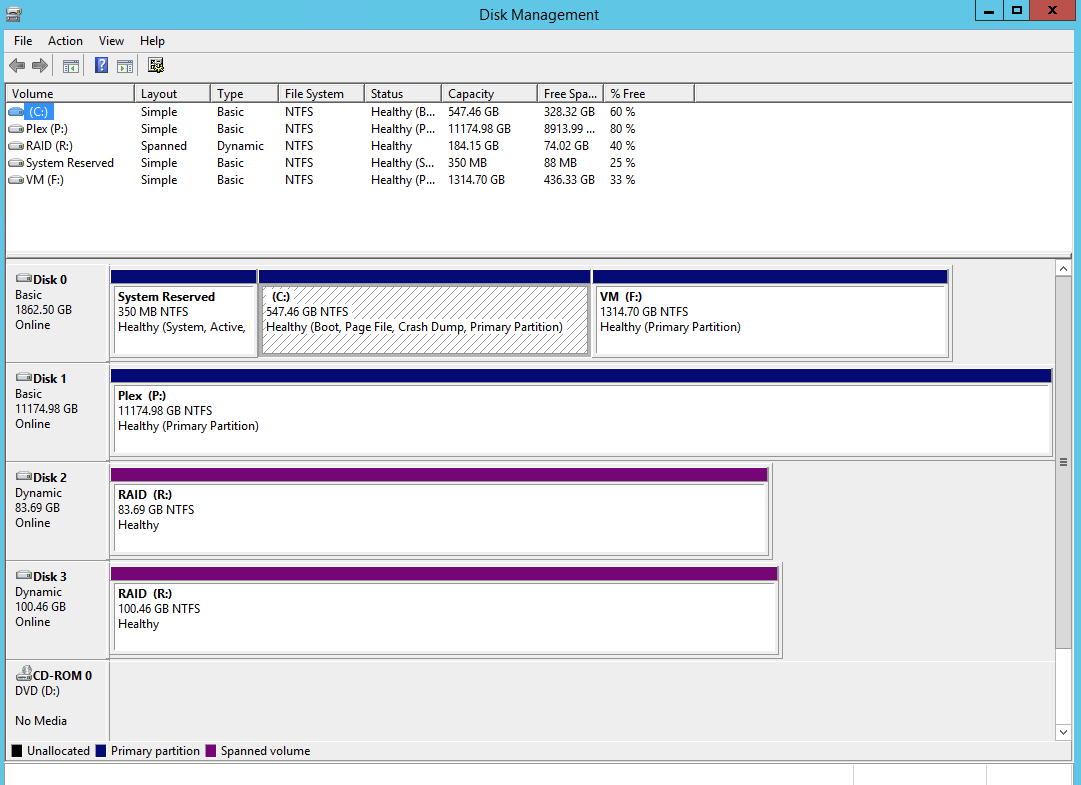

    2025-01-03T22:54:37+00:00
    Hi melvin....here's a new screenshot of the GUEST

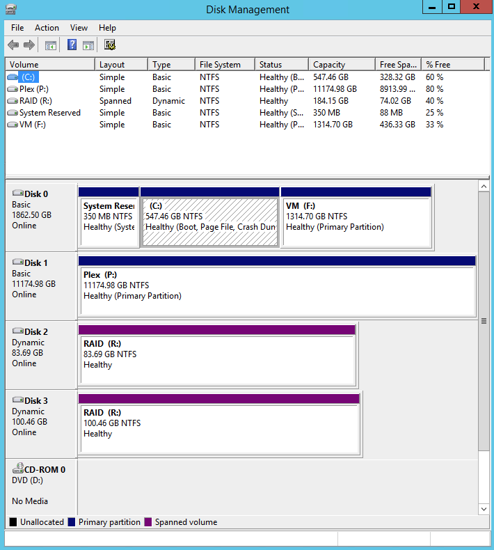

    here is a screenshot of the HOST
    The host is W2012 R2 Server not W10 or W11. The guest is W10. The 350MB NTFFS partition says Healthy(System, Active, Primary Partition).
    the guest is what I am concerned about. The host, I believe is EOL (?) or close to it I think.

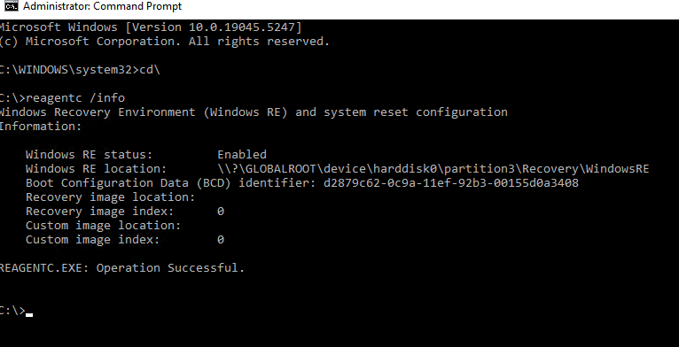

    here is the reagenctc on the Host:
    C:>reagentc /info
    Windows Recovery Environment (Windows RE) and system reset configuration
    Information:
    Windows RE status:         Enabled
    Windows RE location:       \\?\GLOBALROOT\device\harddisk0\partition1\Recovery\WindowsRE
    Boot Configuration Data (BCD) identifier: 155b846b-16e2-11e9-9098-a939de75f708
    Recovery image location:
    Recovery image index:      0
    Custom image location:
    Custom image index:        0
    REAGENTC.EXE: Operation Successful.
    C:>

    2025-01-03T22:00:45+00:00

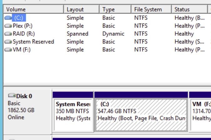

    I see your image:
    It is unfortunate that you did not "widen" that "Status" column, to show more information, especially to show the text below "350 MB NTFS" and to show more of the "Healthy (S..." field.
    Are you running Windows Update on the "(C:)" partition? If so, then if "partition0" really is the "WinRe" partition, then that partition probably is too small (only 88 MB free) for the update to be successfully applied. Use that REAGENTC command on this system, to show which "partition[N]" really is the "WinRE" partition.
    Inside the "guest" VM, can you use the command-line DISKPART utility to assign a drive-letter to that "partition3", and then to see how much disk-space is occupied, and how much space is free? Note that many files on "partition3" are tagged as "hidden" files.
    After assigning a "drive-letter", use the command-line "DIR [drive-letter]: \ /A /S /P" to show All the files & Sub-folders, and to Pause when the terminal-window gets full.

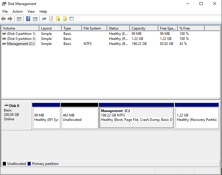

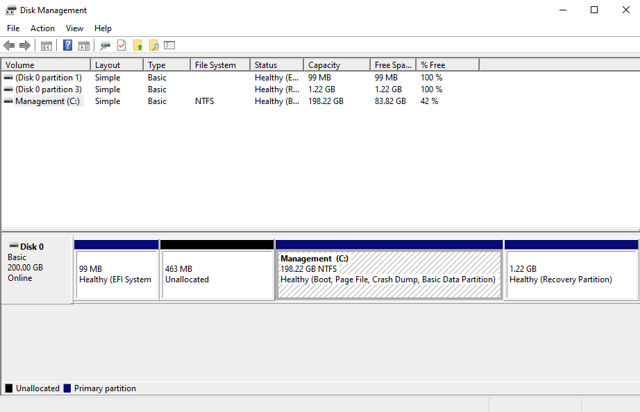

    2025-01-03T13:55:32+00:00
    Hi melvin,
    I was able to expand the 768 to over 1gb see below. I still get the same issue as the other guy where it not attempts the upgrade and eventually quits.
    partition3 is right
