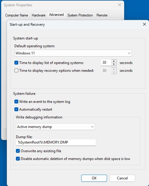

    I'm willing to try, but what is needed is an automatic kernelmode dump. A kernelmode dump contains, more or less, all data in RAM. This includes personal stuff. Files stored on the hard disk are NOT in the RAM. As a general rule of thumb, everything you open might be in the dump. Files lying around passively on the hard disk, not openend, are not in the RAM. Only stuff currently running and not swapped out is in the dump when the BSOD happens. If you were running Edge and watching cat videos, it might be in the dump. But even then, it might be swapped out, because usermode stuff gets swapped out very fastly. (Also, all I care about is getting my hands on the rootkit thing, did I mention that? :-D) Do not just post an automatic dump here, for these reasons. It's also quite large. It would be be put in an encrypted zip with a good password.
    You can switch from minidump to automatic dump in the control panel. MSDN explains how to do this here: https://learn.microsoft.com/en-us/windows-hardware/drivers/debugger/enabling-a-kernel-mode-dump-file
    Also read this: https://learn.microsoft.com/en-us/windows-hardware/drivers/debugger/varieties-of-kernel-mode-dump-files
    And what I would want would be the automatic dump. That's all for now. Consider that you also have the Core Isolation option, and that I may fail to isolate and locate the thing. I will also try to locate all rw primitive drivers, because they might serve as the current entry point. I'm off till Monday now.
