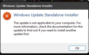

    Thanks but when I open the checkpoint file I get this message:
    What documentation does it refer to and where do I find it?
    Run "winver.exe" and note the OS build number.
    If it says 26100.2894, you don't need the checkpoint update or the KB5050009 update. KB5050009 seems to be repeatedly offered to some users, though it's already installed.
