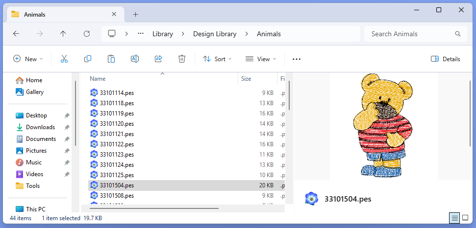

    I tested that download in a Windows 11 virtual machine. I had to disable Windows Defender to allow the download.
    As I suspected, the full install adds the shell extensions that provide thumbnails in icon views and a preview in the Details pane. There is no preview in the Preview pane.

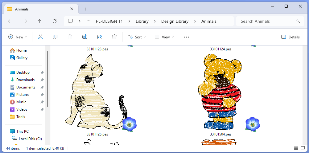

    Windows 11 Details view with Details pane enabled:

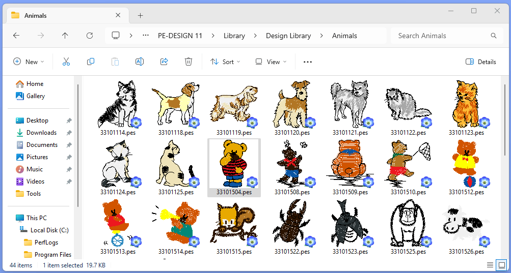

    Large icons view:
    Extra large icons view:

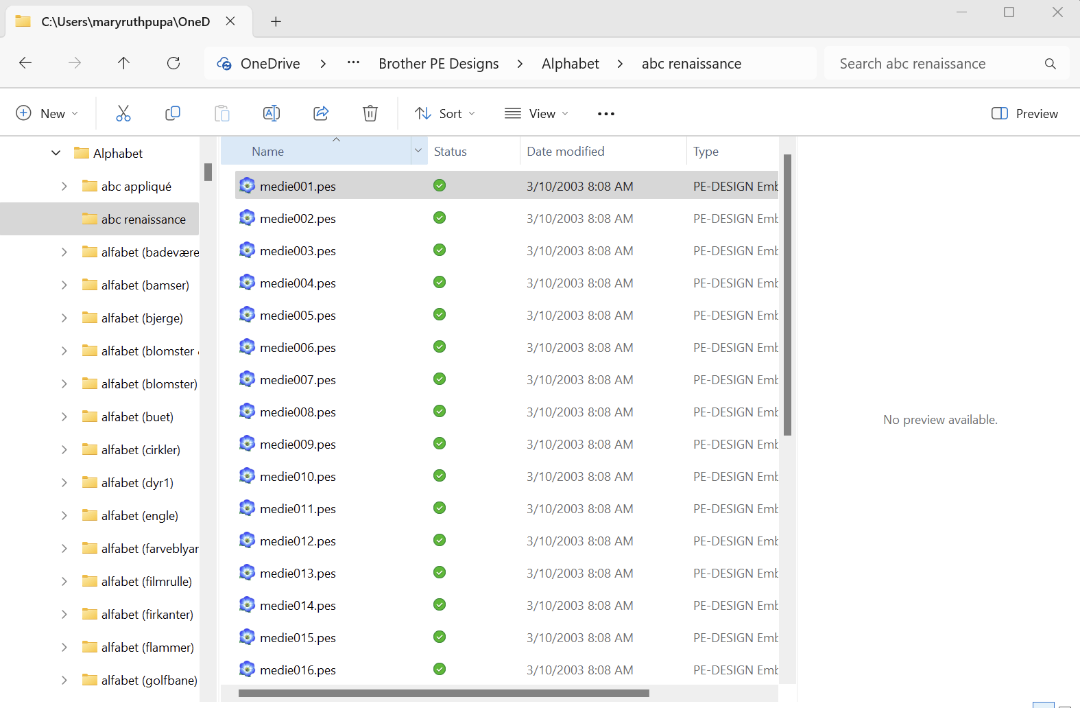

    See attached screen shot from our machine, which does not show the preview.

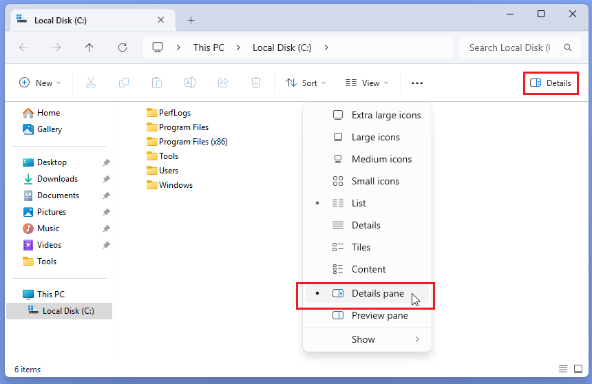

  3. Les Ferch 10,361 Reputation points Volunteer Moderator
    2025-01-08T20:45:30+00:00
    As I stated, you won't get a preview with the Preview pane. Switch the rightmost pane to Details.

    2025-01-08T22:07:36+00:00
    The right pane is on details and I have tried with OneDrive turned off without success.
    Have the files set to remain on PC.
    Any other ideas?
  5. Les Ferch 10,361 Reputation points Volunteer Moderator
    2025-01-08T22:24:39+00:00
    Any other ideas?
    Just to be sure we're talking about the same thing, please see my previous post again. I updated it with a screenshot showing how you can switch the rightmost pane from Preview to Details. I have confirmed that it's exactly the same on Windows 10. That is, the rightmost pane must be set to show Details and not Preview in order to see a preview of the PES files.
    What happens when you switch your main view from Details to icons (medium, large, or extra large)? Do you see thumbnails of the PES files or do you just see the PES flower icon?
    If you don't see any thumbnails, please check a folder that is not a OneDrive folder, such as:
    C:\Program Files (x86)\Brother\PE-DESIGN 11\Library\Design Library\Animals
    Change the view to large icons.
    If you don't see the thumbnails anywhere, try resetting the thumbnail cache by running the batch file from here: https://www.elevenforum.com/t/clear-and-reset-thumbnail-cache-in-windows-11.2051/#Two
