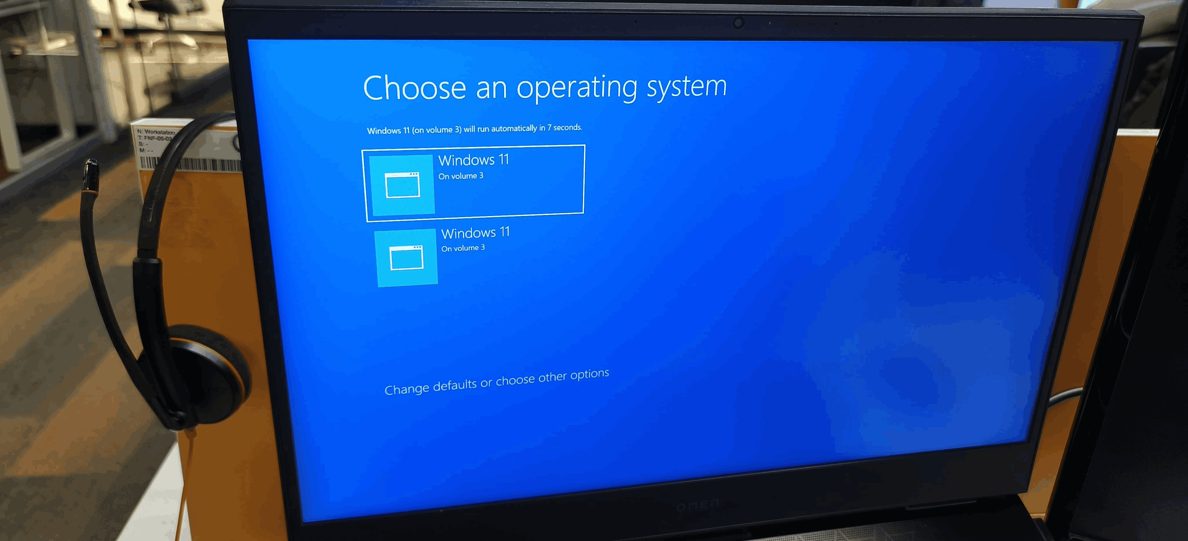

Two days back I received the Windows 11 24H2 Update on my system "HP Omen 16". Following the installation, I observed two identical entries for 'Windows 11 on volume 3' within the boot menu. No selection was made, and the system successfully logged into Windows after a 30-second delay.
The following workday, I consulted with our IT department regarding this behavior. Upon restarting the system in their presence, the dual boot entries reappeared. Attempts to select between the entries were unsuccessful. Proceeding to 'Change defaults or choose other options' and selecting the 'Repair' option resulted in a system freeze, characterized by an automatic reboot loop.

![](https://learn-attachment.microsoft.com/api/attachments/d99e4b91-e430-4162-a12e-e9bb43699141?platform=QnA
