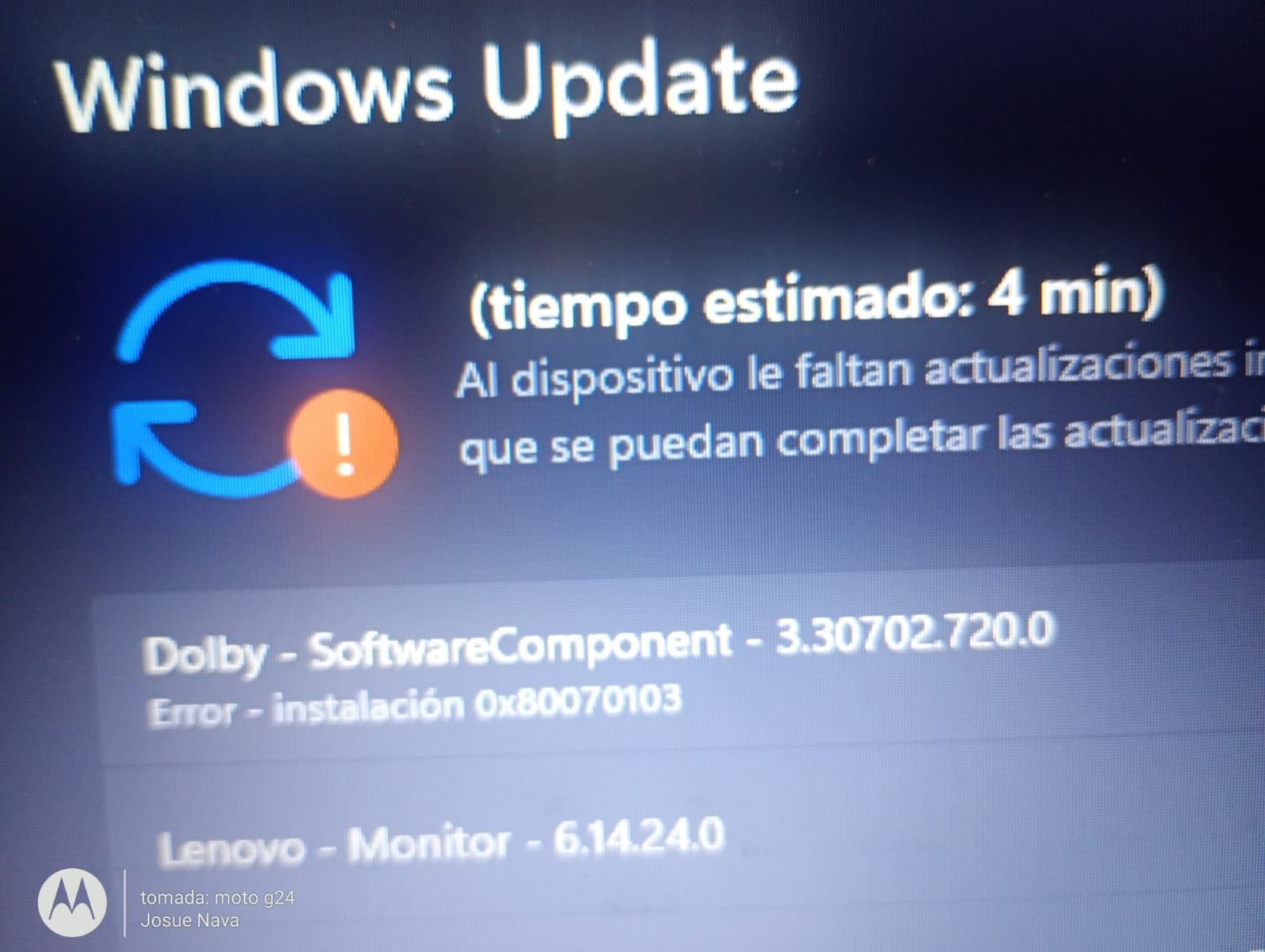

    2025-01-23T20:51:10+00:00
    This error persist even on differents Windows Languages... (Spanish) Dolby does not install... will there be a fix from Lenovo or I'll end up hiding the update
