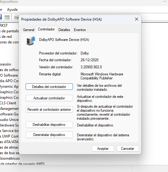

    Oficially DOLBY Issue has been RESOLVED!! the new and free conflict driver is the version 3.20900.902.0,
