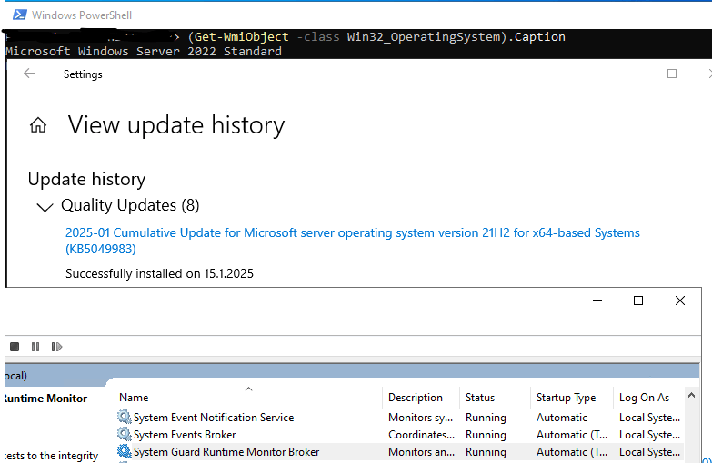

    We ran into the same issue on our Windows 2022 servers only, not on Windows 2019 servers.
    Sgrm service replies an "Access Denied" when attempted to start.
    It appears KB5049983 is to blame for this.
    2025-01-16T13:23:41+00:00
    I changed the registry settings from "Automatic" to "Manual" with remote PowerShell (so I don't have to logon to every server) and got this error message from Microsoft for Endpoint.
    An attempt to tamper with registry keys used by the Microsoft Defender for Endpoint sensor was detected. This activity might indicate malicious intent to interfere with the monitoring of affected machines. This activity can potentially disable the sensor and prevent the machine from sending telemetry to the service. For more information, read the Antivirus tampering technique profile Threat Analytics report:
    So it looks like this service is important. I think we will just have to wait until Microsoft will fix it.
    On Windows Server 2025 this service is disabled.
    I was comparing two Windows Server 2022 and there was definitely update on the sgrmbroker.exe and related files (C:\Windows\System32). The older files are from 15.11.2024 but the new files are from 15.1.2025.
    I'm not going to recommend this, but what you can do is
    1. Take ownership of the files and press "ok"
    2. Then add yourself to security with full permission and press "ok"
    3. Rename SgrmBroker.exe, SgrmEnclave.dll, SgrmEnclave_secure.dll and SgrmLpac.exe to what ever (SgrmBroker.exe.old)
    4. Copy this four files from server which has not been updated. With "Date modified" as "15.11.2024"
    5. Reboot the server
    I have just done this in test environment
