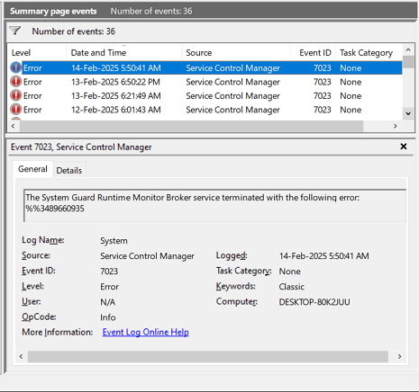

Hello all. I am on Win10 Home Version 22H2  OS Build 19045.5371 on a HP Omen Desktop and a HP Envy Laptop. I noticed today upon checking my Event Viewer after installing patch Tuesday updates Cumulative Update for Windows 10 Version 22H2 for x64-based Systems KB5049981 and KB5050188 and also KB890830 I started seeing the below Event 7023 Service Control Manager....SgrmBroker.exe (System Guard Runtime Monitor Broker] Terminated with Error %%3489660935 after restarting my computer. I have run SFC and DISM and did not find any integrity violations. I am not seeing any other computer problems except this error. Tried to change the System Guard Runtime Monitor Broker Service but access is denied and remains on Delayed Start. I do not use Windows Defender but I use Norton 360 Select Plus on both computers. Is anyone else seeing this and is there a solution for this error. I have tried everything including the registry “HKEY_Local_MACHINE\SYSTEM\CurrentControlSet\Services” Start setting change from 3 to 4 but that causes a lot of Security SPP errors so I changed the value back and did a system restore that I had made before hand. It would appear the Update problem is with KB5049981. Microsoft this needs to be fixed as I feel the integrity of the Windows platform is at risk with this service not starting like it is suppose to do.

Log Name:      System
Source:        Service Control Manager
Date:          1/14/2025 3:48:16 PM
Event ID:      7023
Task Category: None
Level:         Error
Keywords:      Classic
User:          N/A
Computer:      DESKTOP-
Description:
The System Guard Runtime Monitor Broker service terminated with the following error:
%%3489660935

User 0xb1a’s 20-Jan-2025 post <here> in this topic includes the contents of Microsoft bulletin WI982633 stating that Microsoft is aware of this bug and has marked the status as "Mitigated". From that bulletin:
"This service was originally created for Microsoft Defender, but it has not been a part of its operation for a very long time*. Although Windows updates released January 14, 2025 conflict with the initialization of this service, no impact to performance or functionality should be observed.*
There is no change to the security level of a device resulting from this issue. This service has already been disabled in other supported versions of Windows, and SgrmBroker.exe presently serves no purpose*.*
Note: There is no need to manually start this service or configure it in any way (doing so might trigger errors unnecessarily). Future Windows updates will adjust the components used by this service and SgrmBroker.exe. For this reason, please do not attempt to manually uninstall or remove this service or its components."
The "Known Issues" section of the release notes for KB5049981 (OS Build 19045.5371, released 14-Jan-2025 ) at https://support.microsoft.com/help/5049981 states that "We are working on a resolution and will provide an update in an upcoming release" so I'm hoping the February 2025 Patch Tuesday updates scheduled for 11-Feb-2025 will include a bug fix that stops these System Guard Runtime Monitor Broker service (SgrmBroker.exe) Event ID 7023 errors.

    See Susan Bradley's 23-Apr-2025 announcement Windows 10 finally gets fix in the AskWoody forum.
    A Preview (BETA) update for Win 10 is now available that should fix our System Guard Runtime Monitor Broker service (SgrmBroker.exe) Event ID 7023 errors, but I'm going to wait for the next stable monthly cumulative Quality Update to be released with the May 2025 Patch Tuesday updates on 13-May-2025 since this bug doesn't appear to cause any noticeable problems on my system.

    I installed the May 2025 Cumulative Update for Win 10 Version 22H2 for x64 (KB5058379 / OS Build 19045.5854, released 13-May-2025) and these System Guard Runtime Monitor Broker service (SgrmBroker.exe) Event ID 7023 errors are no longer logged in my Event Viewer at Windows Logs | System at each Windows 10 startup.
    See Lawrence Abrams's 13-May-2025 BleepingComputer article Windows 10 KB5058379 update fixes SgrmBroker errors in Event Viewer for further details.
