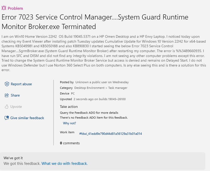

Hello all. I am on Win10 Home Version 22H2  OS Build 19045.5371 on a HP Omen Desktop and a HP Envy Laptop. I noticed today upon checking my Event Viewer after installing patch Tuesday updates Cumulative Update for Windows 10 Version 22H2 for x64-based Systems KB5049981 and KB5050188 and also KB890830 I started seeing the below Event 7023 Service Control Manager....SgrmBroker.exe (System Guard Runtime Monitor Broker] Terminated with Error %%3489660935 after restarting my computer. I have run SFC and DISM and did not find any integrity violations. I am not seeing any other computer problems except this error. Tried to change the System Guard Runtime Monitor Broker Service but access is denied and remains on Delayed Start. I do not use Windows Defender but I use Norton 360 Select Plus on both computers. Is anyone else seeing this and is there a solution for this error. I have tried everything including the registry “HKEY_Local_MACHINE\SYSTEM\CurrentControlSet\Services” Start setting change from 3 to 4 but that causes a lot of Security SPP errors so I changed the value back and did a system restore that I had made before hand. It would appear the Update problem is with KB5049981. Microsoft this needs to be fixed as I feel the integrity of the Windows platform is at risk with this service not starting like it is suppose to do.
