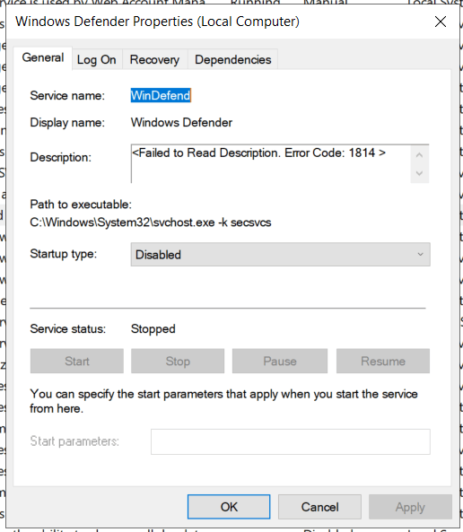

    Side issue is that microsoft defender service cannot be enabled in services.msc
    You got any fixes for it?
    2025-02-07T13:24:44+00:00
    2025-02-07T13:28:30+00:00
    well that absolutely did nothing i mean this.
