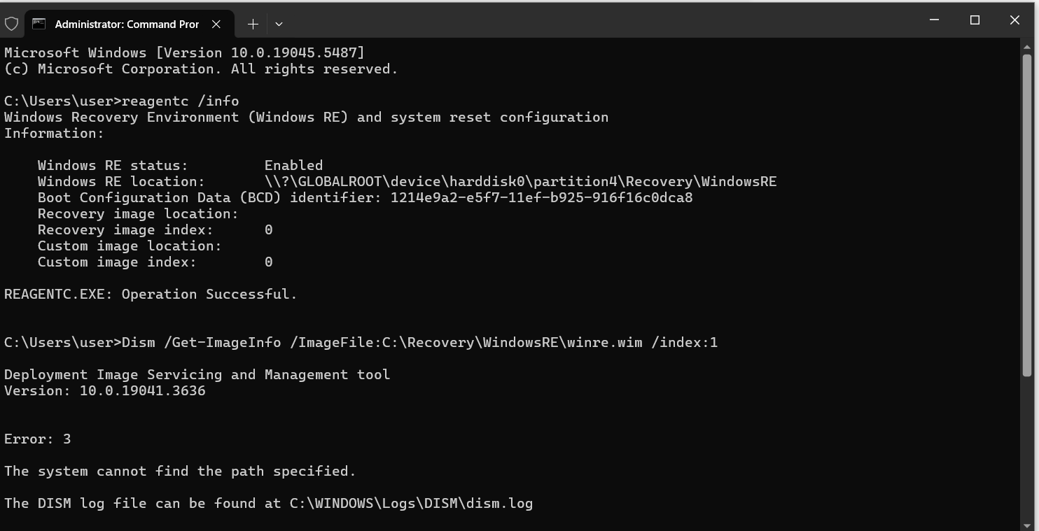

This error will not go away I kid you not. After increasing my recovery partition to 1GB and yet still there, ive already digged into the web deep enough and yet not even working. And no, I don't use bitlocker, just please get this annoyance off.
These 2 updates are the reason holding me back from updating windows properly
KB5050411
KB5042320

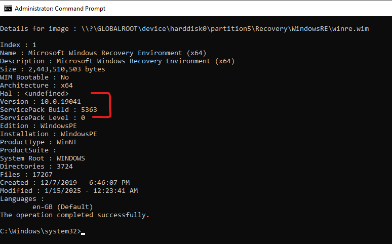

WinRE is now updated.
Your earlier output posted today.
The latest output.
It's good now.
You can update the WinREVersion registry value here if it's not already updated.
HKEY_LOCAL_MACHINE\SOFTWARE\Microsoft\Windows NT\CurrentVersion
Hopefully, WU will no longer offer that update.
