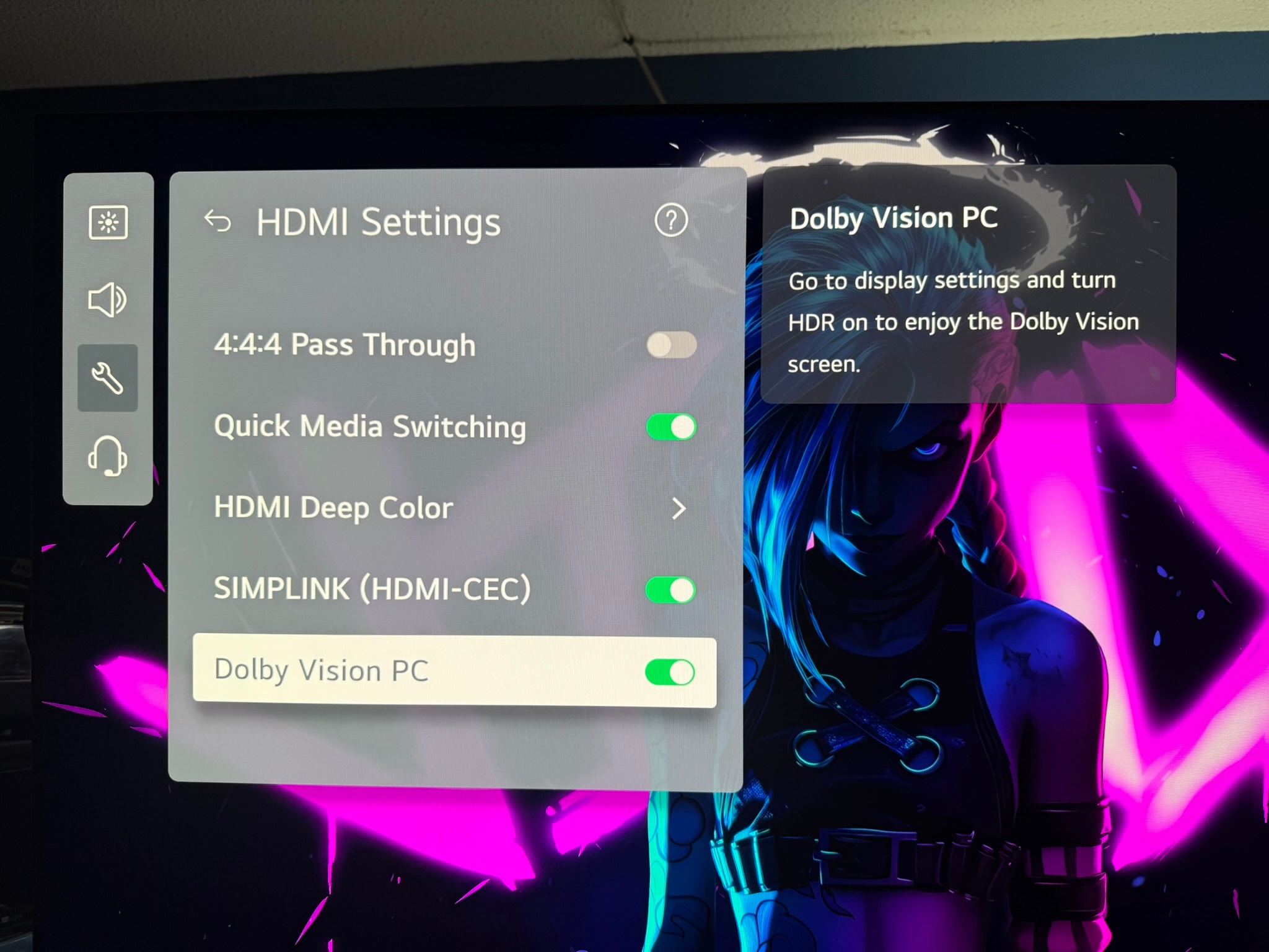

2025-06-20T11:23:20+00:00 Well I got my 55" G5 today, at first i thought it was suffering the same issue, however I discovered that i had to put the PC into " use Dolby vision mode" first and it would look like the pink/green puke but with an extra bit of F-you by the bottom third of the screen looking like the screen was physically damaged, but before I turned it off I went into the the LG settings and under "General>>External Devices>>HDMI settings there is a "Dolby Vision PC" switch, when I turned that on it worked as intended, I never checked the G2 for this setting in this location and Don't feel like hooking it back up.
And oh my word is jumping from a G2 to a G5 an epic upgrade!!!!
Dolby Vision and Dolby Vision PC must be functionally different and I now think we should treat them as such as it seems as though that is what is happening, I also now believe that older TV's even if they support dolby vision may never get this functionality, if it is just software/firmware then hopefully manufacturers like LG who say they will give 5 years of feature upgrades will roll this back to older TV's
But if it is TV hardware dependant I don't think there is much hope.
