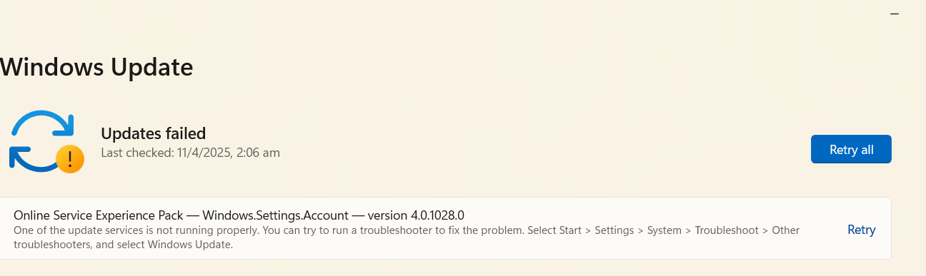

I cannot update my system.it keeps saying failed no matter how many times i press retry
2025-04-22T16:56:27+00:00
I cannot update my system.it keeps saying update failed no matter how many times i press retry.My mousepad is also not working,and i am thinking that this might be due to the system update fail

    Sorry for the delay in reply. I've been offline.
    Thanks for the screenshots.
    The error indicates that one of the update services is not running. This may be due to the service being disabled for some reason or possibly because the service is corrupted.
    It's a good idea to begin by checking the status of the services. Try enabling and running them manually to see if errors occur or are displayed during the process.

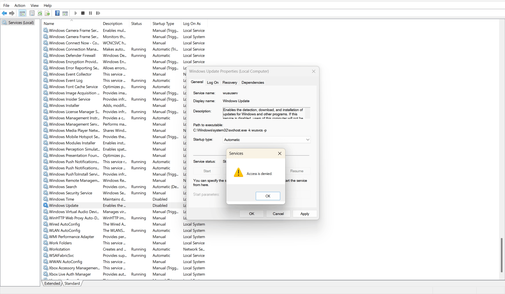

    2025-04-23T13:56:58+00:00
    Step 1 to 5 was successfull but when proceeding to step 6,i failed to start the window update
  3. David-M 126.5K Reputation points Independent Advisor
    2025-04-23T14:09:16+00:00
    Thanks for the clarification.
    You have found the cause of the issue.
    Although it looks like a permissions issue, it is most likely a corruption issue.
    However, I suggest trying the Windows Update Troubleshooter if you haven't already tried. It may give more clues or even fix the problem.
