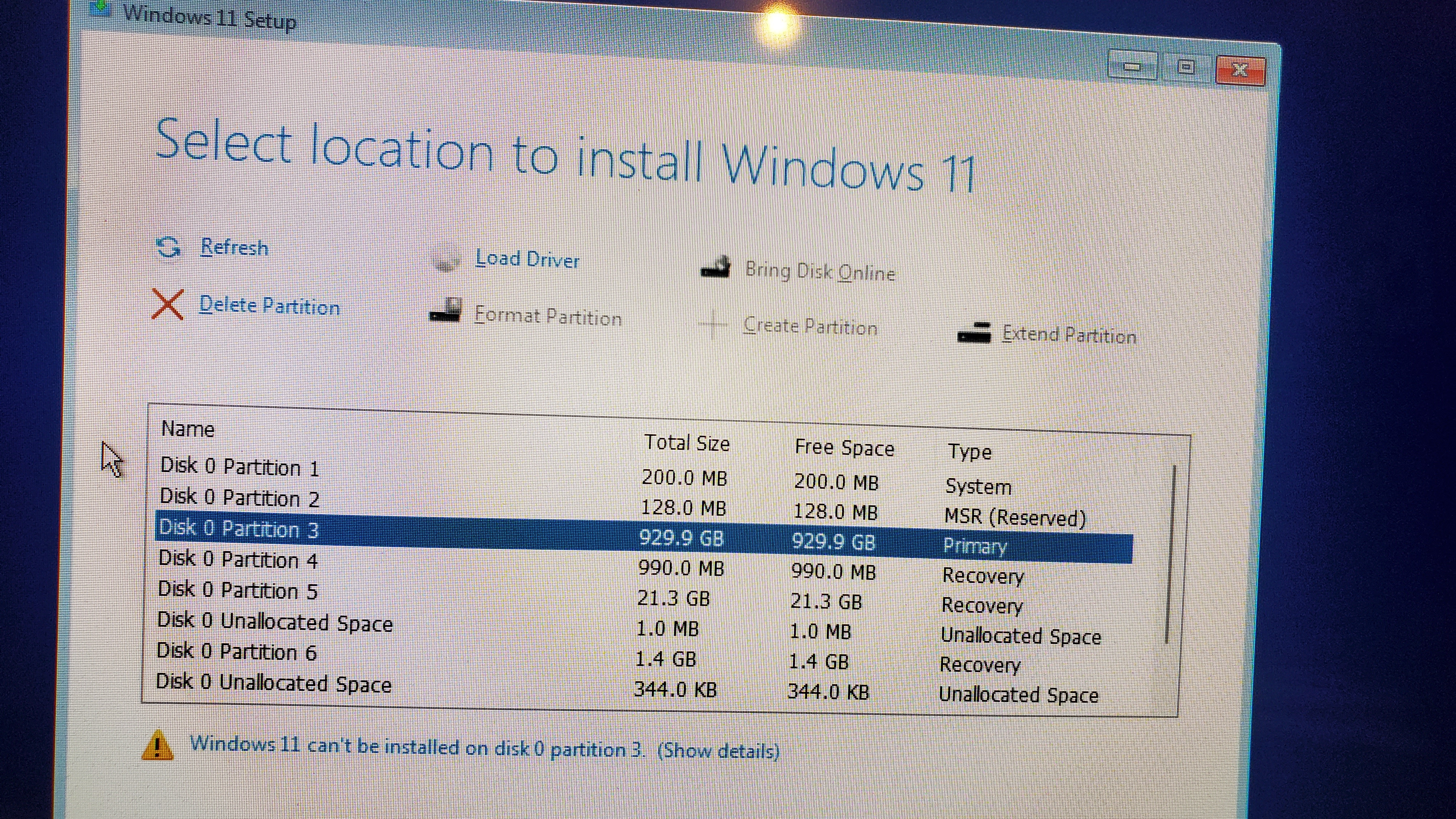

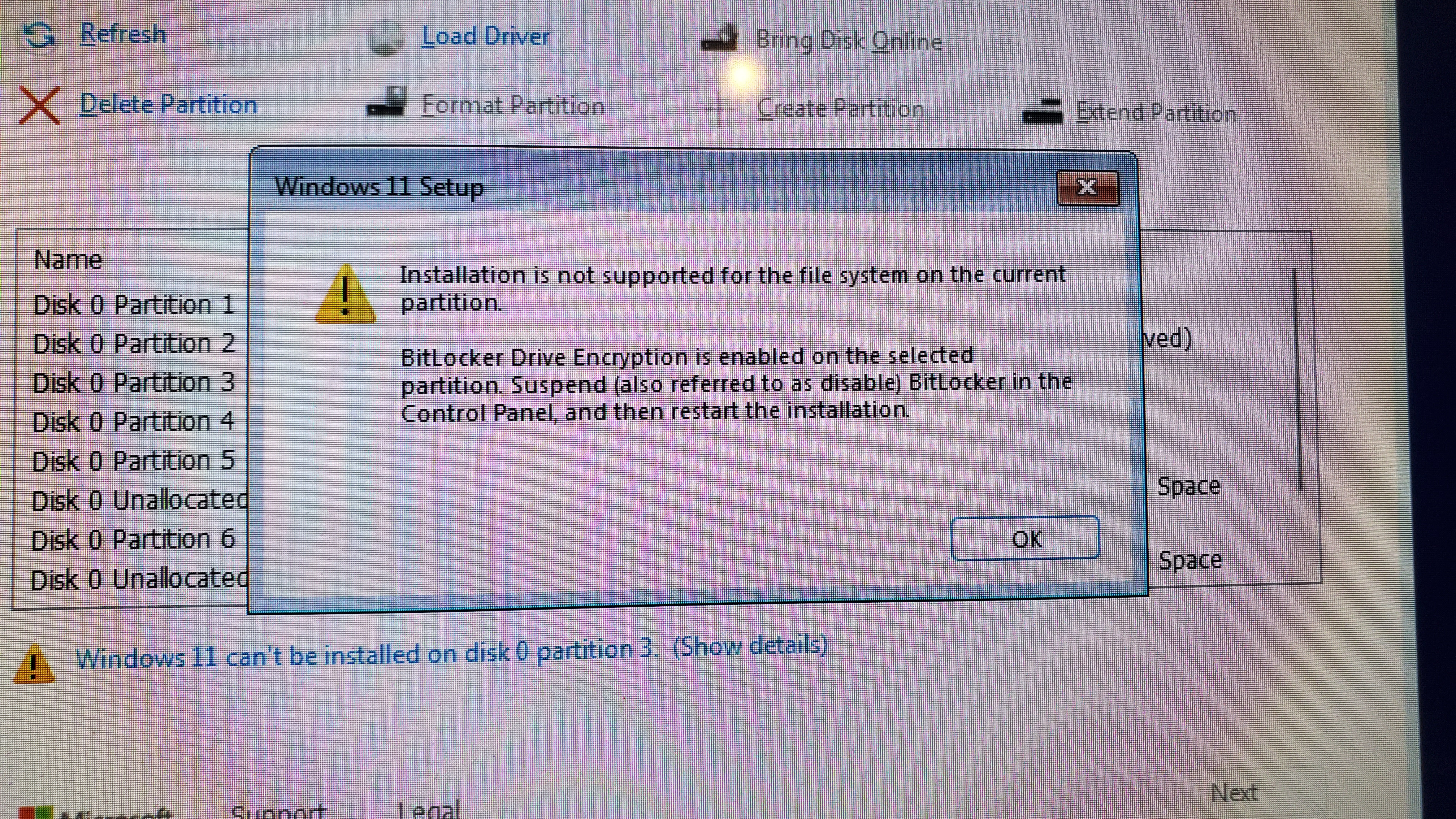

  1. Manoel Barros 22,030 Reputation points Independent Advisor
    2025-04-27T16:47:37+00:00
    Thanks for your feedback!
    You should select the Disk 0 Partition 3 option. But as you have shown, BitLocker is preventing the installation.
    Try disabling it this way:
    1. Press SHIFT + F10 to open Terminal.
    2. Now let's type the following commands.
      ATTENTION: Type the entire command on the first line > Press ENTER > Wait for the command to complete > Run the next command in the list.
    manage-bde -off X: -rp
    X: - Replace the letter X with the letter of the encrypted drive and then add the colon.
    • Usually in WinRE, the letter of the Main Drive is D. To confirm, type the command below and see if the Windows folders appear (Program Files, Windows, Users...)
    dir D:
    • If the Windows folders do not appear, try C:
    dir C:
    The letter of the Encrypted Drive will be the drive that has Windows files.
    EXAMPLE:
    manage-bde -off C: -rp 123456-789012-345678-901234-567890-123456-789012-345678
    1. Use the Command below to check the unlock status of the Encrypted Drive.
    manage-bde -status C:
    1. When the "Percentage Encrypted" option is at 0%, it means the drive is BitLocker free.
    2025-04-27T16:34:57+00:00
    It won't allow me to install on the largest hard drive. Get this message. I do, however, have the BitLocker number if that helps. Otherwise, how do I disable this?

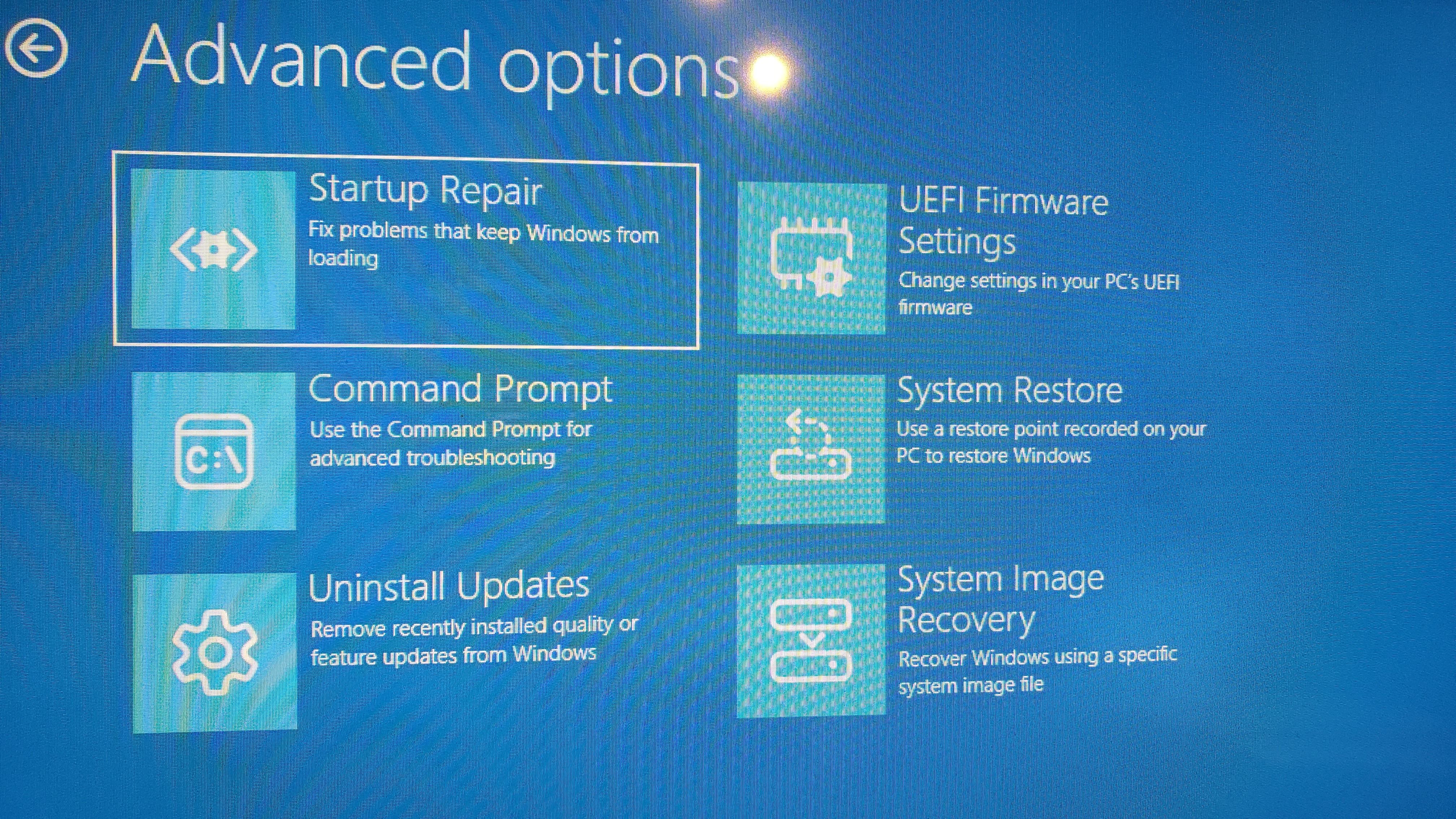

    2025-04-27T15:26:24+00:00
    Keep it on "Primary?" ... FYI, last night it wouldn't let me post any more, so that's why I didn't post all the photos. I didn't see an "Advanced" option. Let me know if you still need those photos.Image
