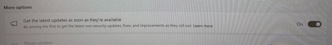

    1. Hvciscan still flags those uninstalled driver packages. Maybe there are leftover registry entries or the system needs a reboot.
    2. WU cache has been reset and all services are running fine. Please turn off preview updates.
    1. Update Defender manually using this command:
    • "C:\Program Files\Windows Defender\MpCmdRun.exe" -SignatureUpdate -MMPC
    1. Restart Windows and scan for updates. Those two preview updates should not appear. Let's see if it offers KB5055523.
    2025-04-28T18:21:40+00:00
    I rebooted my system and then turned off that "Get the latest updates" option.
    I ran the MpCmdRun.exe and it said it worked.
    I then restarted it again and these updates are there 20250428_181921801_iOS.heic
