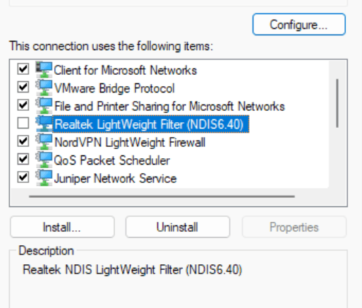

  1. Ramesh 181.2K Reputation points Volunteer Moderator
    2025-05-17T15:56:49+00:00
    Try uninstalling it. Select the Realtek LightWeight Filter (NDIS6.40) entry and click "Uninstall."
    Also, uninstall these components if listed:
    • VMware Bridge Protocol
    • VirtualBox NDIS6 Bridged Networking Driver

  3. Ramesh 181.2K Reputation points Volunteer Moderator
    2025-05-18T02:55:04+00:00
    Hi, sms1295
    Removing "Realtek LightWeight Filter (NDIS6.40)" and running that fixlist.txt should most likely resolve the 24H2 upgrade issue altogether. You could try that option first.
    **Uninstalling Dragon (from Realtek) via Apps & Features should remove that NDIS 6.0 driver.**

  5. Ramesh 181.2K Reputation points Volunteer Moderator
    2025-05-18T11:43:09+00:00
    Hi sms1295,
    You may find software named "Dragon" in Apps and Features. It's a Realtek product that installs the NDIS 6.x driver. Please uninstall Dragon.
    Post Fixlog.txt if possible.
