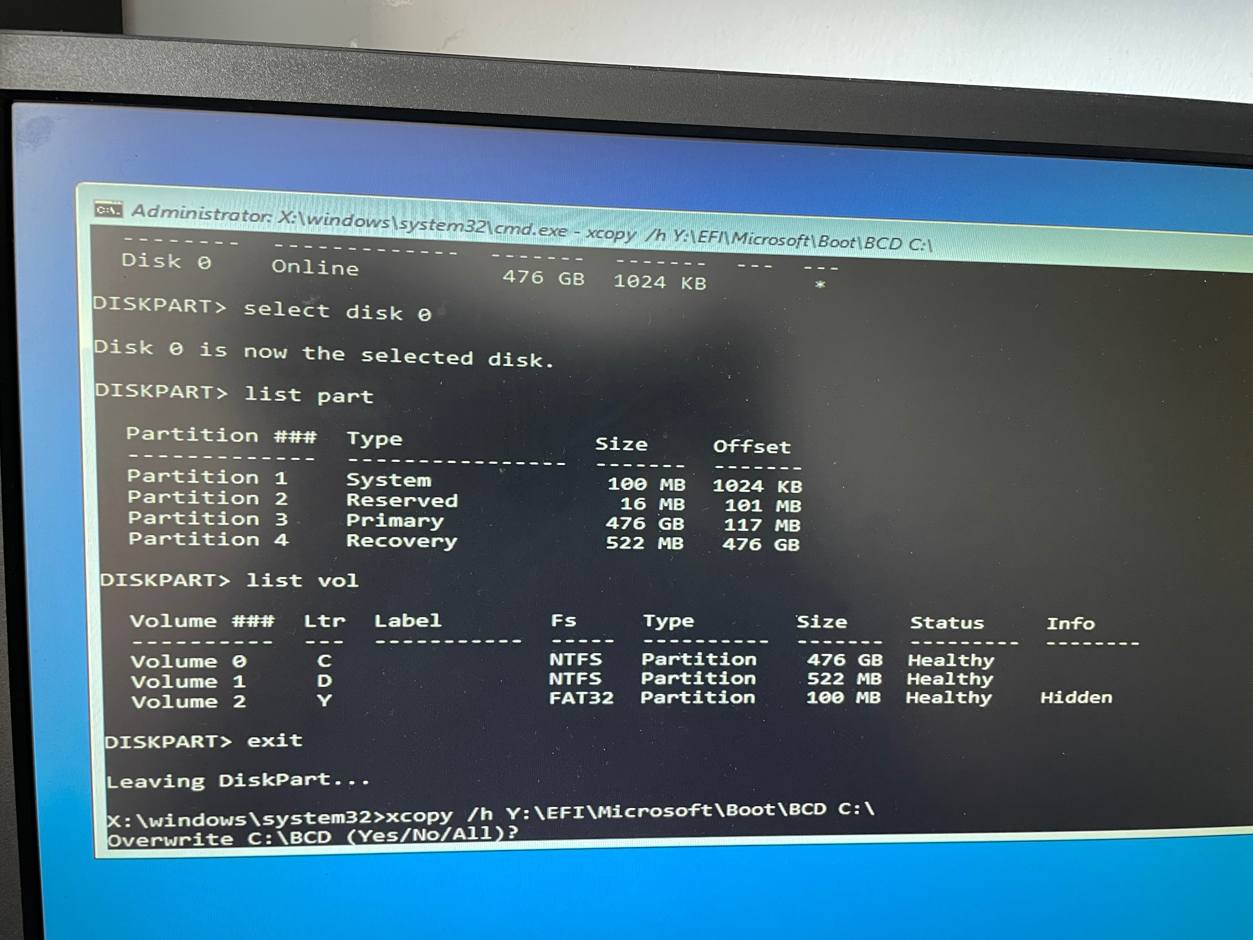

    Sorry it’s taken a while for me to boot to WinRE again. I’m doing the commands and I get this: I want to be absolutely sure but it’s safe to select Yes?
  4. Ramesh 181.9K Reputation points Volunteer Moderator
    2025-05-04T16:24:27+00:00
    Click Yes.

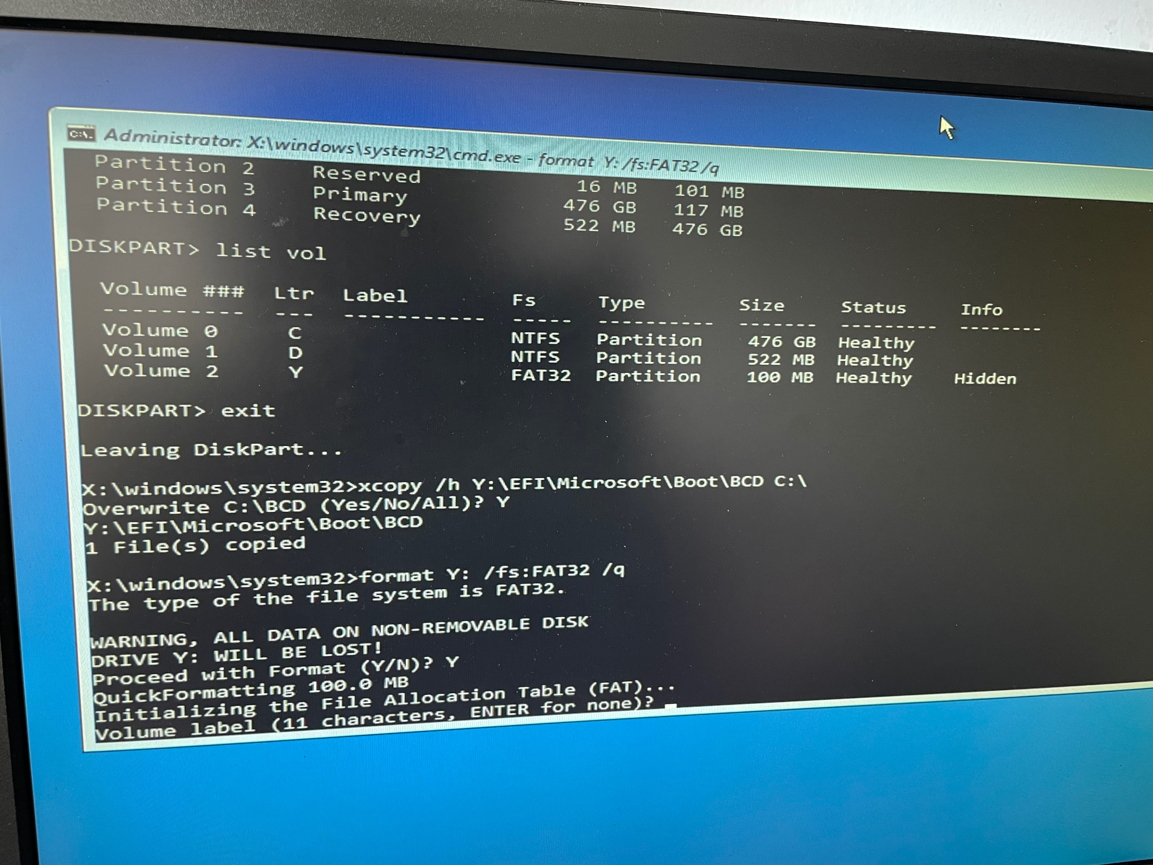

    2025-05-04T16:30:03+00:00
    Here do I press enter or write EFI and then enter?
