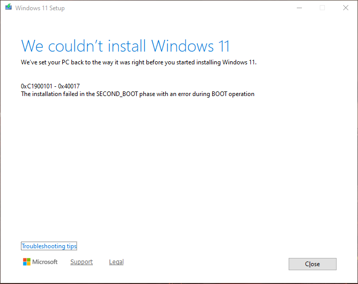

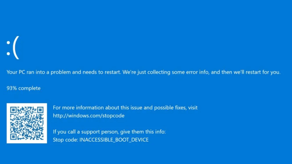

I've been trying to upgrade from Windows 10 to Windows 11 for over a month now. Each time I get blue screen message stating: Inaccessable Boot Device. After my computer loads back into Windows 10 I get another error message saying that the Installation Failed in the Second Boot Phase. I've tried upgrade via the upgrade exe file that you can get from microsoft, and through a Windows 11 installation media file that I created.
I've also tried removing all excess/old drivers and ensuring that all of my drivers, and my BIOS are up to date. I've tried enabling and disabling secure boot, unplugging everything except my mouse, hard drives, and an aRGB controller that is pretty difficult to get to.
I also made sure to check my discs and registry to remove and repair any issues there.

Update: we were unable to upgrade to windows 11 without doing a fresh install. But this issue persisted even when trying to do a fresh install so I have marked the solution for when you get these errors while attempting a fresh install that worked for me.
