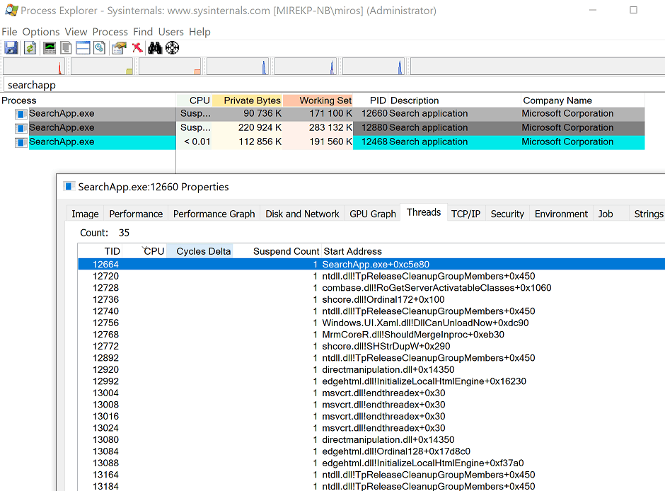

    Could you guys do some research please?
    Download process explorer ( Process Explorer - Windows Sysinternals | Microsoft Docs). Run procexp64.exe as Administrator. Filter for searchapp, dblclick the greediest one, switch to Threads tab, sort by CPU descending and drop prinscreen here. E.G.:
    (unfortunately mine doesn't misbehave so i cannot help directly)
