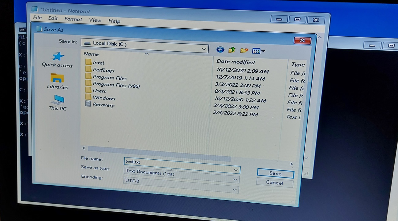

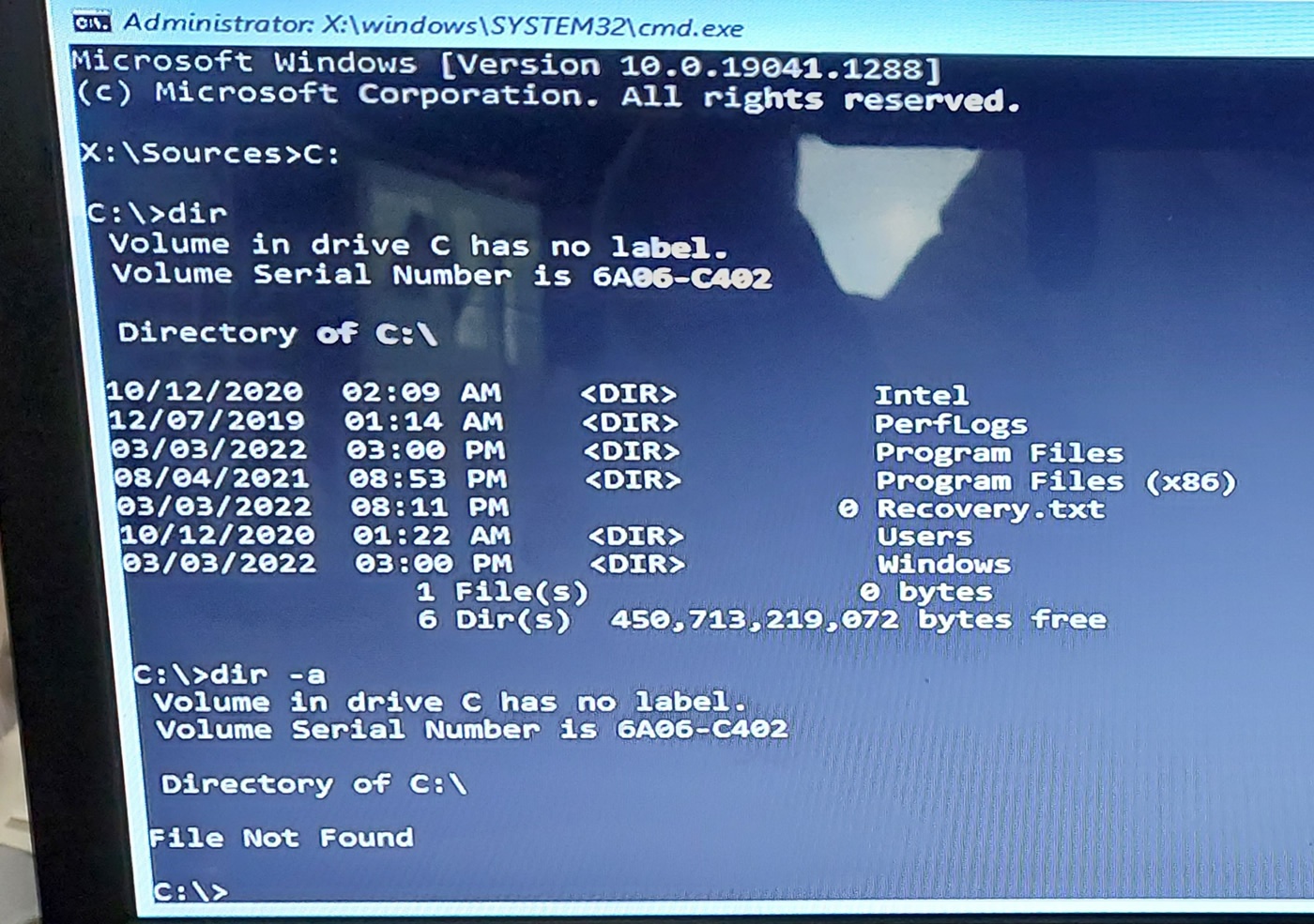

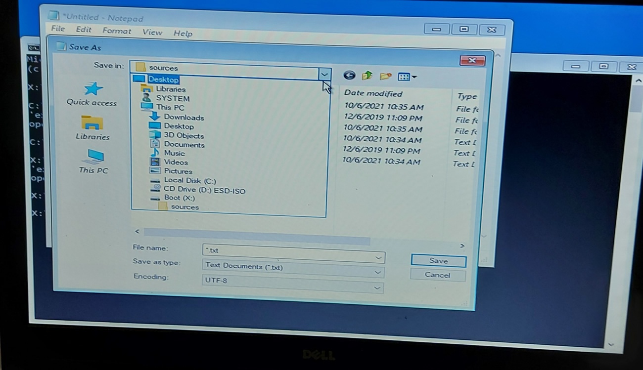

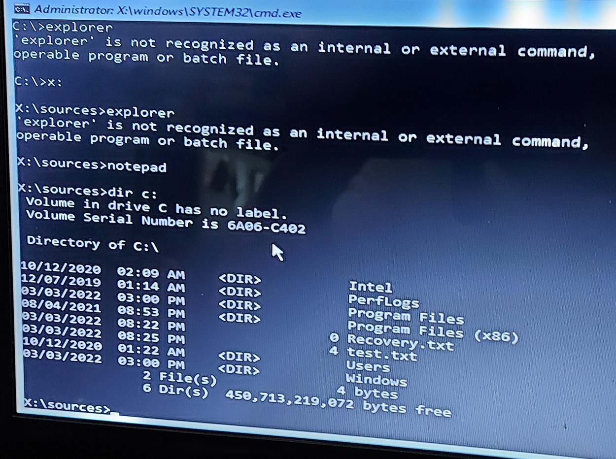

    Hello Dave,
    is from Windows 10 Installation DVD 21H2
    Also, look here additionally:

    Hi Lse123polis
    Okay, that is great, the file structure on that drive is complete.
    When you boot form that DVD, instead of choosing to install or upgrade Windows, select 'Repair this Computer', and try each of the options available in there, to see if you can get that drive to boot.
