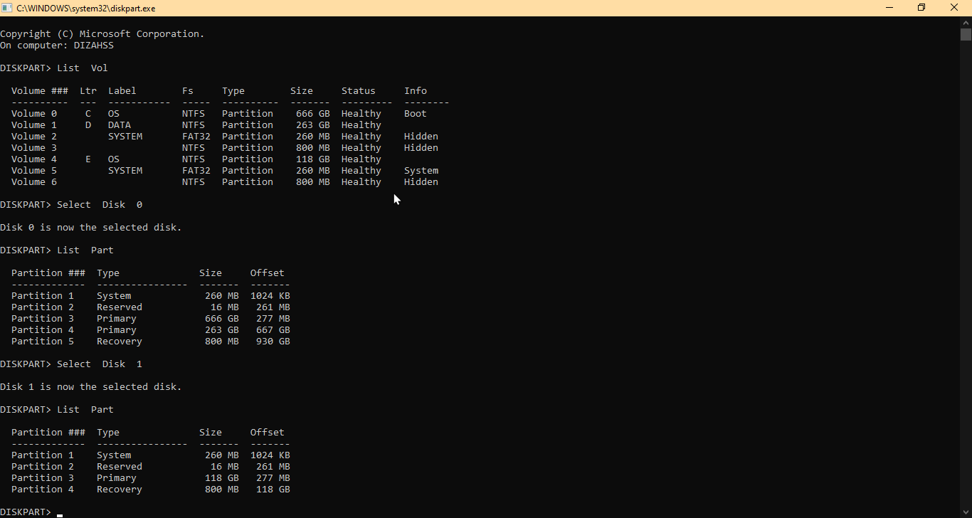

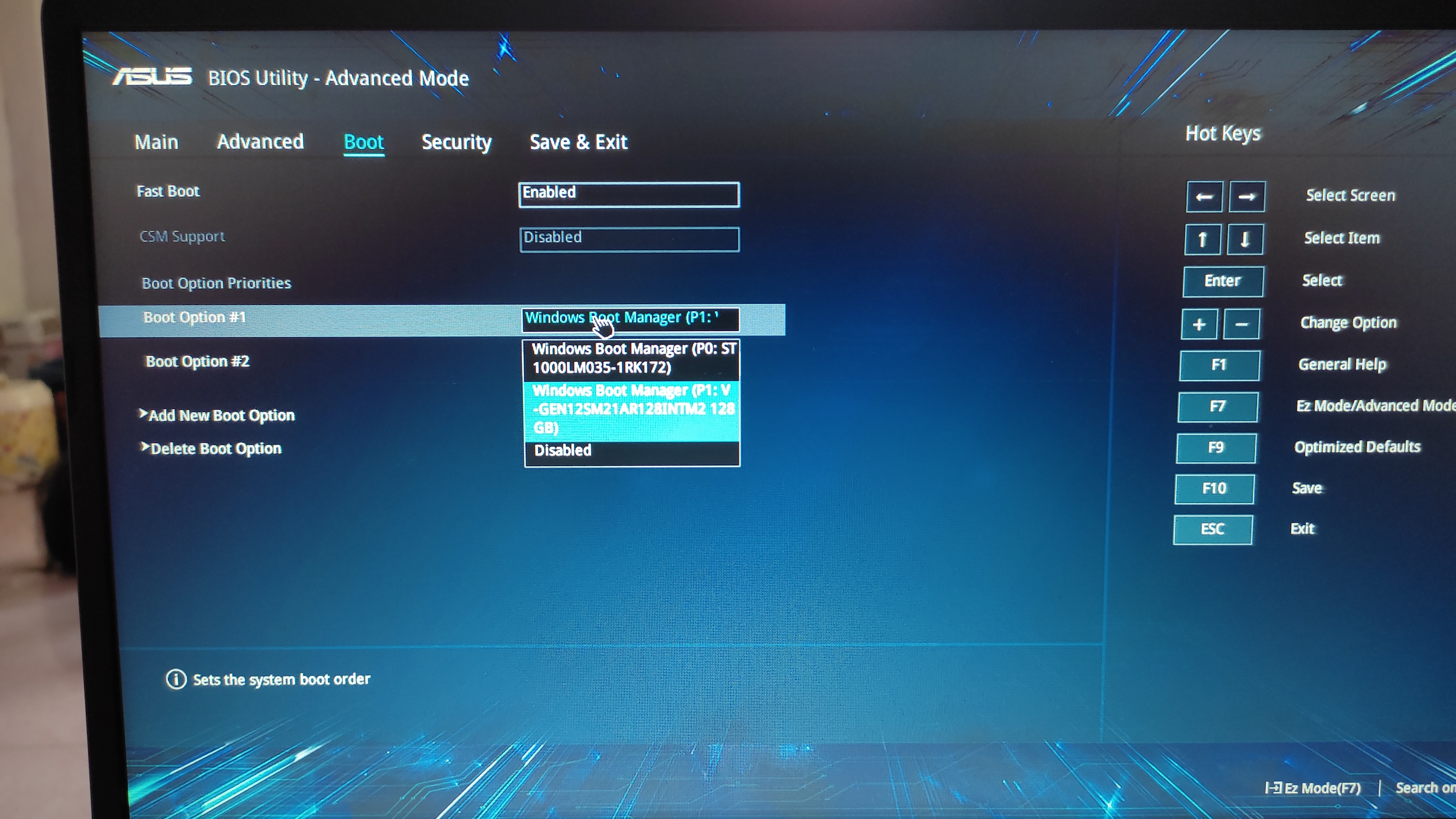

Hey all, I am Dizah.
I recently upgraded my computer with a V-GEN SSD, I installed it properly and it works. I cloned my HDD to my SSD. I changed the boot priority 1 as my SSD and disable the boot priority 2. The restart process happened, I successfully signed in to my computer. But then I checked the disk management, I found that the booting process still happens from the HDD, as this image shows.
I am unsure that I have successfully switched the booting process from HDD to SSD. If anyone could get back to me that would be great.

That indicates BIOS did indeed direct the boot to EFI of the SSD. Its BCD is in use & can't be renamed. So, let's do it from the Recovery Environment (RE). But drive letters may be different there. So...
(a) Click any Power icon, then hold Shift as you click Restart.
 That should reboot to the RE at the "**Choose an Option**" screen.
(b) Click "Troubleshoot > Advanced Options > Command Prompt"
 That reboots again to a Command Prompt.
(c) Enter the following commands...
DiskPart <<<Enter DiskPart
List Vol <<<List the volumes & their letters
=== Examine the listing to see what letter is on the partition of size 118 GB. That will ===
=== be the SSD's Windows partition. Use that letter instead of E: (if different) in the ===
===BCDBoot command below. And if Volume 5 has a letter, use it instead of S:. ===
List Disk <<<See that Disk 1 is the SSD by its size
Select Disk 1 <<<Focus on the SSD
Select Partition 1 <<< EFI System partition of the SSD
Assign Letter=S <<<Give it letter S (if it doesn't already have a letter)
Exit <<<Exit DiskPart
DEL S:\EFI\Microsoft\Boot\BCD.old <<<In case BCD.old exists, delete it
REN S:\EFI\Microsoft\Boot\BCD BCD.old <<<Rename current BCD to BCD.old (not necessarily S:)
BCDBoot E:\Windows /s S: /f UEFI <<<Not necessarily letters E: or S:
DiskPart
Select Vol=S <<<Focus on EFI (not necessarily letter S:)
Remove Letter=S <<<Remove the letter S
Exit
(d) Close the Command Prompt with its "X" or type Exit.
(e) Click "Continue" to reboot to Windows
That should do it. Good luck. After booting, show me the BCD. You won't be able to copy/paste in the RE, so print this out first.

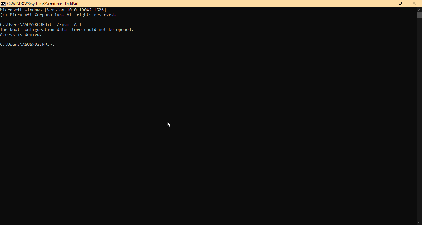

    all the codes work and completed successfully. but unfortunately, the recovery environment still stunted.
    here are the pictures:

    (1) At an Administrator Command Prompt, start with...
    BCDEdit /Export C:\BCD_Backup <<<Backup the BCD
    Then, copy/paste these one at a time to create the Device Options object It is just 3 lines...
    BCDEdit /Create {4d163c57-d6af-11eb-a988-93a3341b5547} /d "Windows Recovery" /device
    BCDEdit /Set {4d163c57-d6af-11eb-a988-93a3341b5547} ramdisksdidevice partition=\Device\HarddiskVolume9
    BCDEdit /Set {4d163c57-d6af-11eb-a988-93a3341b5547} ramdisksdipath \Recovery\WindowsRE\boot.sdi
    And for the Windows Boot Loader Object, it is 11 lines...
    BCDEdit /Create {4d163c56-d6af-11eb-a988-93a3341b5547} /d "Windows Recovery Environment" /application OSLOADER
    BCDEdit /Set {4d163c56-d6af-11eb-a988-93a3341b5547} device ramdisk=[\Device\HarddiskVolume9]\Recovery\WindowsRE\Winre.wim,{4d163c57-d6af-11eb-a988-93a3341b5547}
    BCDEdit /Set {4d163c56-d6af-11eb-a988-93a3341b5547} path \windows\system32\winload.efi
    BCDEdit /Set {4d163c56-d6af-11eb-a988-93a3341b5547} locale en-US
    BCDEdit /Set {4d163c56-d6af-11eb-a988-93a3341b5547} inherit {bootloadersettings}
    BCDEdit /Set {4d163c56-d6af-11eb-a988-93a3341b5547} displaymessage Recovery
    BCDEdit /Set {4d163c56-d6af-11eb-a988-93a3341b5547} osdevice ramdisk=[\Device\HarddiskVolume9]\Recovery\WindowsRE\Winre.wim,{4d163c57-d6af-11eb-a988-93a3341b5547}
    BCDEdit /Set {4d163c56-d6af-11eb-a988-93a3341b5547} systemroot \windows
    BCDEdit /Set {4d163c56-d6af-11eb-a988-93a3341b5547} nx OptIn
    BCDEdit /Set {4d163c56-d6af-11eb-a988-93a3341b5547} bootmenupolicy Standard
    BCDEdit /Set {4d163c56-d6af-11eb-a988-93a3341b5547} winpe Yes
    That should do it. Edit: It didn't do it. This needed to be added...
    ReagentC /Info <<<Show whether the RE is enabled
    ReagentC /Enable <<<Enable it
    ReagentC /Info <<<Show it is enabled
    Add a BCDEdit /Enum All, then Ctrl-A & Ctrl-C to paste the result. Finally, Shift+Restart should get to a full featured recovery environment. Good luck.
