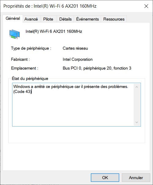

    2022-02-12T03:25:49+00:00
    Here is error 43, after disabling / enabling for some reason. It seems to be kind of random like it just switch for code 10 and code 43
