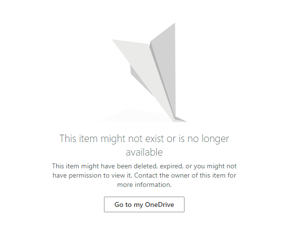

    2021-09-05T07:14:57+00:00
    I can't download the dump file, "This item might not exist or is no longer be available".
    2021-09-05T13:34:10+00:00
    Iv continued trying to troubleshoot on my own and had no luck.
    Iv managed to both open the files myself and get the link working properly, Being that I dont use onedrive, I wasnt aware that the URL in the address bar was NOT viable, It works now that Iv used the in file browser share button, and copied this link from it. These are only a small portion of my crashes, most havent brought upon the BSOD at all but have simply immediately shut down without warning or, seems like not even an event log in either system or application logs.
    If youd be so kind as to tell me which lines of the dump file are the errors I should start with researching in the future that would be lovely, Im the tech support in my circles but I need more experience with software and windows.
    https://1drv.ms/u/s!AoMx1wrzNVdRiQ0iyGlVsmdu2qie?e=gmfIB2
