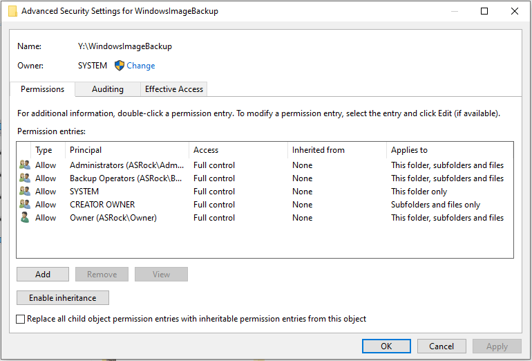

    2021-08-19T01:31:27+00:00
    After copying my image file and checking the Permissions and Owner, the owner was "Administrator" on the copy and "System" on the Original.. I cahnged it to "System" manually..
    On a 3rd image I created and never actually opened, which would require clicking on a "Open As Admin" type box, the Security Tab and Advanced Button provided completely different results..
    You may notice that there is a User "Backup Operators" which is not present on the copy..
    You may also notice that "System" is the owner, but is not listed as a "User" at all for some reason ..
    This image works properly.. At least it did before clicking the "Open As Admin" box.. I have not tested it since..
    After returning to the WindowsImageBackup folder, double clicking, and clicking the "Open As Admin" type box, I then got different "Security Tab" and "Advanced" windows as shown below...
    I changed nothing on any of these windows.. This was all done by Windows with different results dependent upon whether the "Open As Admin" had been clicked or not..
    With the haphazard type rules that the Backup+Restore seems to impose upon itself, I couldn't even guess as to what effects these differences would make as to the usability of the image...

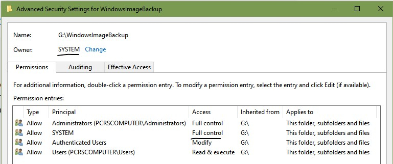

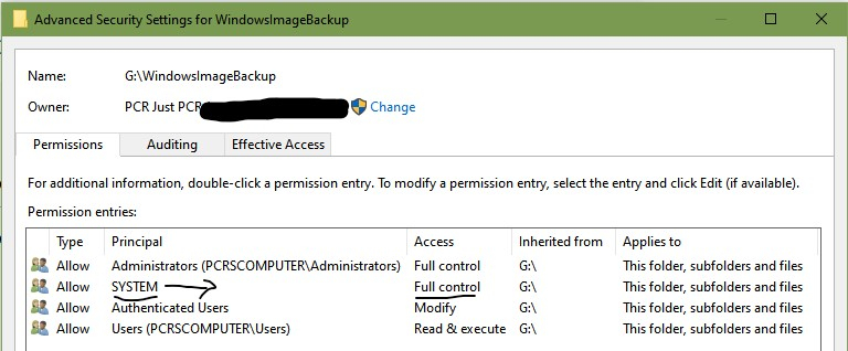

    2021-08-18T21:41:40+00:00
    System already had full permissions, but I was the owner. I changed the owner to System, but still the drive won't show up in Backup & Restore...
    It was,,,
