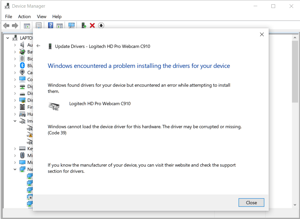

Hi, I purchased a Microsoft Surface Laptop 4, and can't install either of my Logitech Webcams.  When I plug in the C910, it installs with an Exclamation point next to it.  When I plug in another one, it comes up with installing the Webcam Pro 9000 and the exclamation point.  I have tried to uninstall, install, reboot, multiple things, and I keep coming back to the same problem.  I can't find any drivers to install on the logitech website.
I have looked at multiple threads on this site and tried several things and failed.  Any ideas?

    2021-05-12T04:11:18+00:00
    Hi Augie, thanks for getting back to me.  Below is a picture.  Note that the Logitech is sitting under Imaging devices, and not Cameras.  It is the same on my other computer.  The driver details are listed below.  LMK your thoughts.  Thanks.
    2021-05-12T04:30:18+00:00
    The camera does appear to use the Logitech drivers (dated 2012) which may not be compatible with core isolation.
    You could try switching the driver to the built-in Windows driver (native UVC driver) which would not have that issue:
    https://support.logi.com/hc/en-us/articles/3600...
    Note: This is a non-Microsoft website. The page appears to be providing accurate, safe information. Watch out for ads on the site that may advertise products frequently classified as a PUP (Potentially Unwanted Products). Thoroughly research any product advertised on the site before you decide to download and install it.
