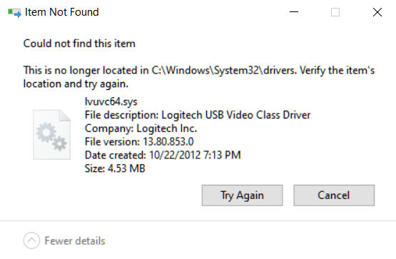

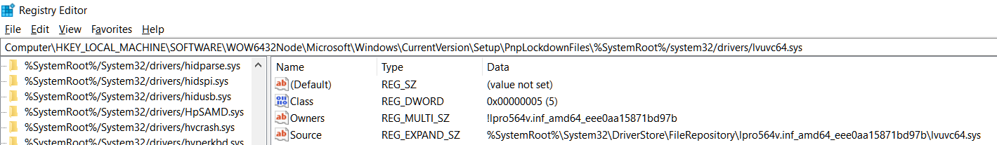

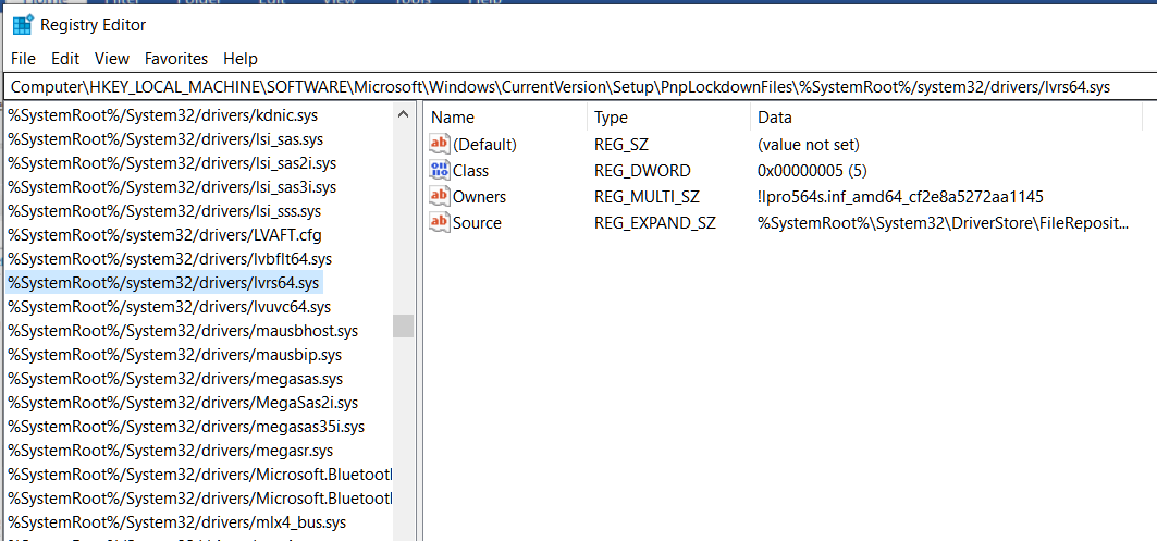

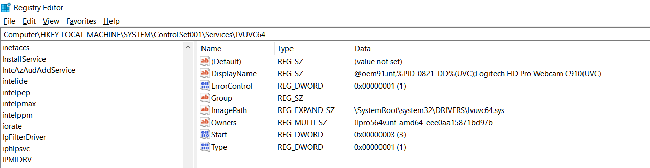

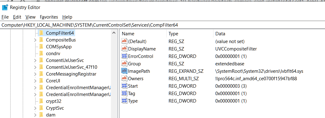

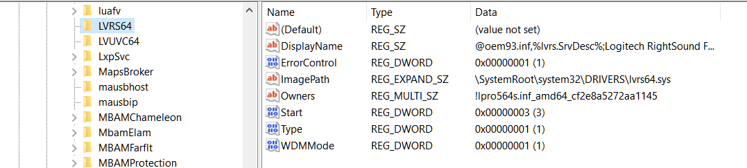

    2021-05-20T02:04:36+00:00
    You can delete them or change to Start value to 4 which would prevent the driver from loading.
    Here's a good link on changing the service state (4 disables the service):
    http://smallvoid.com/article/winnt-services-regedit.html
    Create a System Restore Point beforehand and restart the computer after.
    Then try to move, rename or delete the problematic Logitech drivers.
    Here is a similar topic - one user had to resort to booting to a command prompt to delete the drivers:
    https://answers.microsoft.com/en-us/windows/forum/all/memory-integrity-blocked-by-windows-10-drivers/915f2a4c-026d-42b8-84fb-c4818e1934e8

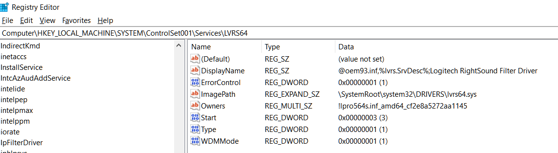

    2021-05-19T02:24:58+00:00
    Anyone have any new thoughts on this problem?
    Should I be deleting any registry entries listed above?
    Thanks,
    Mitchell

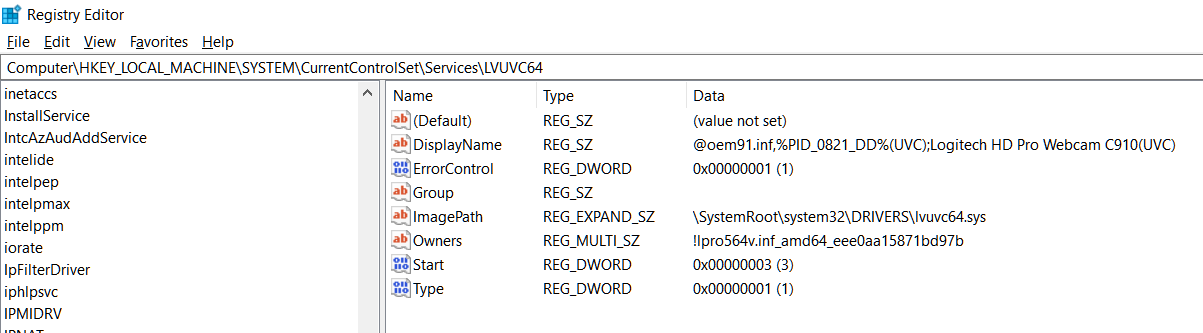

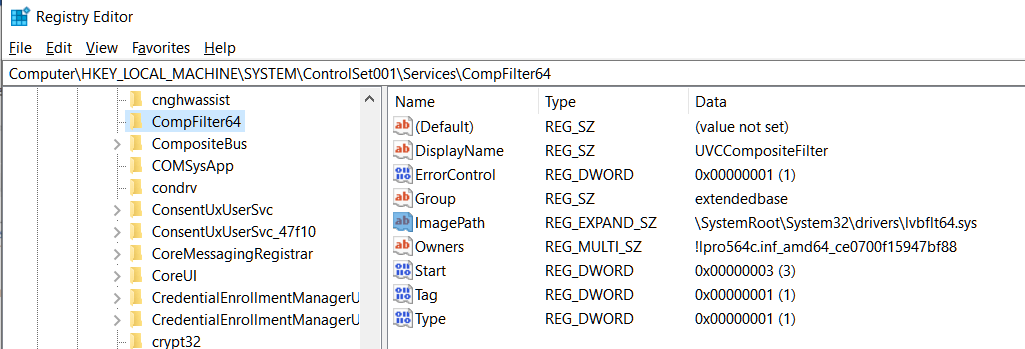

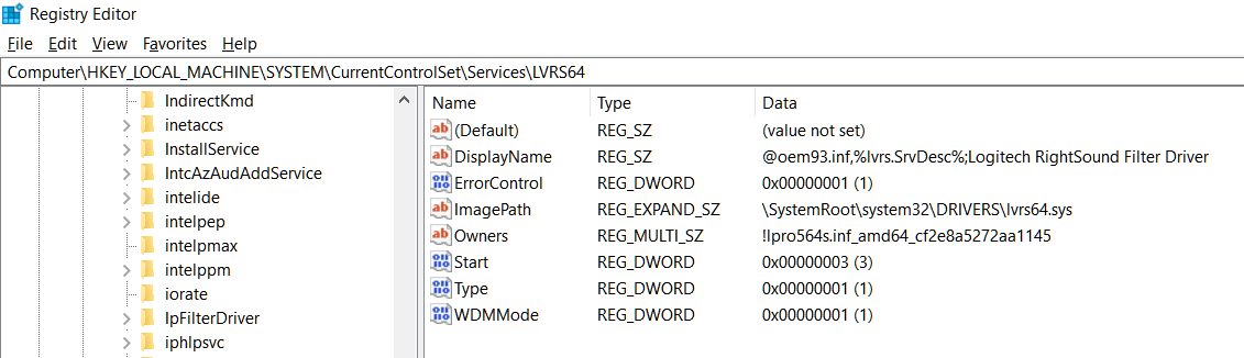

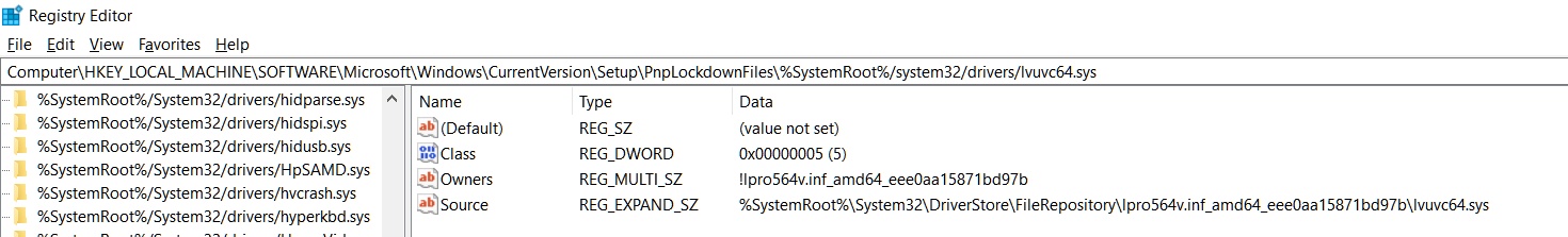

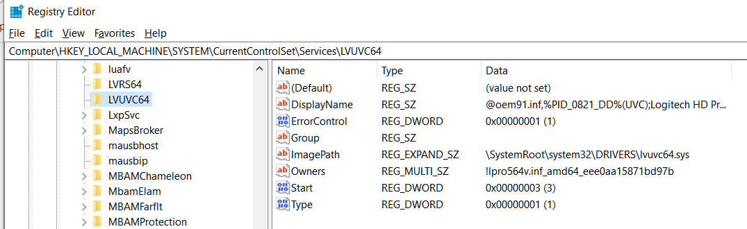

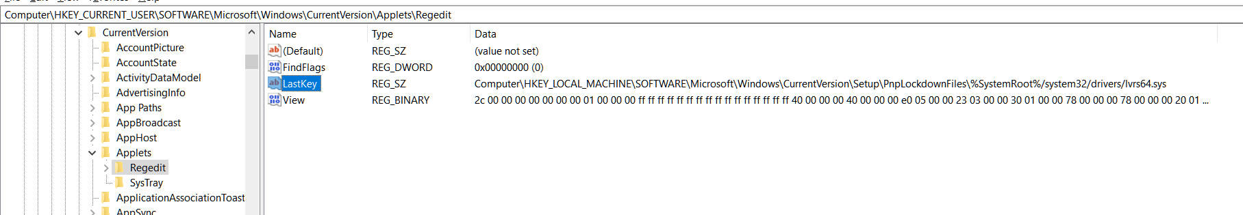

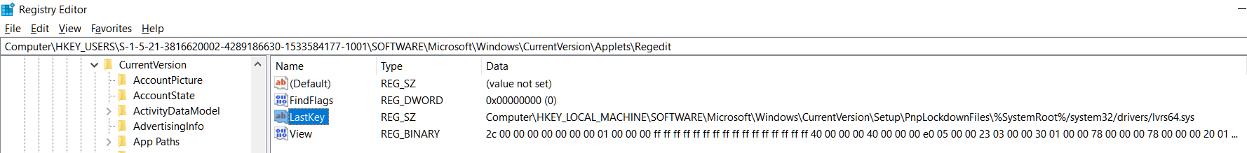

    2021-05-16T23:51:22+00:00
    Yes, here is what I have, and I checked in a few other places...as you can see below
