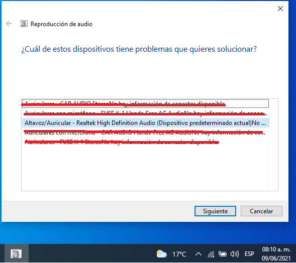

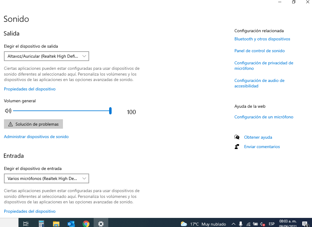

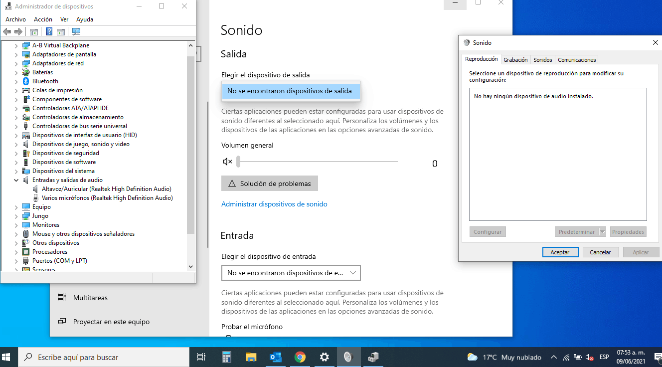

    No, i dont get any message when i remove my sounds devices, at first i cant even see my internal devices (Cause this happen to me in my Laptop Lenovo L560), but i show you what i mean.
    As you can see, i have my devices detected in my device manager, but no eligible as input/output. At this point, what i have to do is click OPEN SOUND SETTINGS, then SOUND SETTINGS and once you do this, you will se the same Sound Settings Screen but with your devices eligibles.
    At this point, 1/2 of the problem is fix because the sound icon is still with red icon, once you run troubleshooting tool, now you can hear with any device, at this point the problem is Temp fixed and any other device you plug will work just fine.
