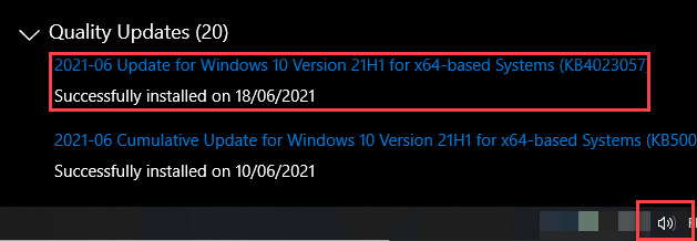

    2021-06-19T16:43:06+00:00
    My computer solved itself alone... when going on it with RDP (it's a remote computer), the sound icon (taskbar bottom right) is back normal.
    Did not do anything. So checking if there was any update installing automatically and I see this one:
    KB4023057: Update for Windows 10 Update Service components (microsoft.com) https://support.microsoft.com/en-us/topic/kb4023057-update-for-windows-10-update-service-components-fccad0ca-dc10-2e46-9ed1-7e392450fb3a This patch is installed after each major update in my history (updated of course, MS reuse the KB number).
    Maybe you can check for Updates
